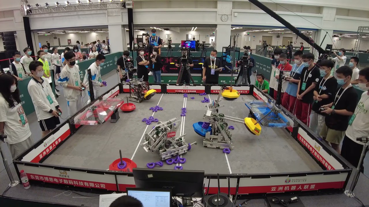

The fact of the matter is that now people are usually rushing at this point to make something and the Vex Moby bot specializes in taking the platforms that hold the rings so I mean that is probably gonna be the most common besides clawbot.
We probably won’t see the day of competitive moby robots because they lack a lot of key aspects needed for this game. They can only hold 1 mobile goal, and can not do rings. They can’t lift mogos to the platform, which is a major problem against any other team that can. They are slow and only have 2 motor drives, so they will be pushed around a lot. While moby is way better than the clawbot, I don’t see them ever becoming a robot that could compete against most custom ones.
No but I am saying on a Qualifier level there will be plenty of beginners because around here they enter the high school level automatically, I did not want to build one but there is a rush for a qualifier so we will build that then we will build what I am sketching and looking into. It will be inspired by the Duel in Dublin 2077x 3303S Vs 2657A 58593A
A clawbot with enough rubber bands can offload mobile goals onto the platform and use its claw to drag them around the field.
