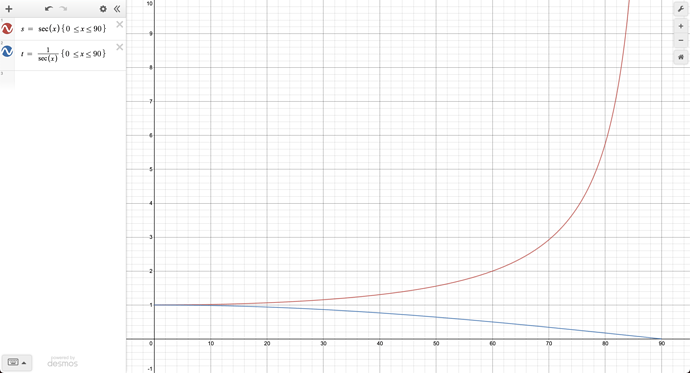

Here’s a graph showing how the multipliers for speed (red) and torque (blue) would change depending on wheel angle, with 0 degrees being parallel to the direction of motion.

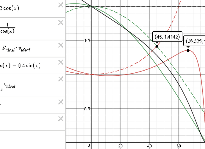

I wonder if you could use Calculus and do an optimization problem based on the constraints of the motor outputs. You would solve for maximum speed based on the wheel angle when the motors are operating at maximum efficiency. Maybe there are too many variables for one problem, but it can actually be quite simple when the other parameters are defined.
This is how you do it.
