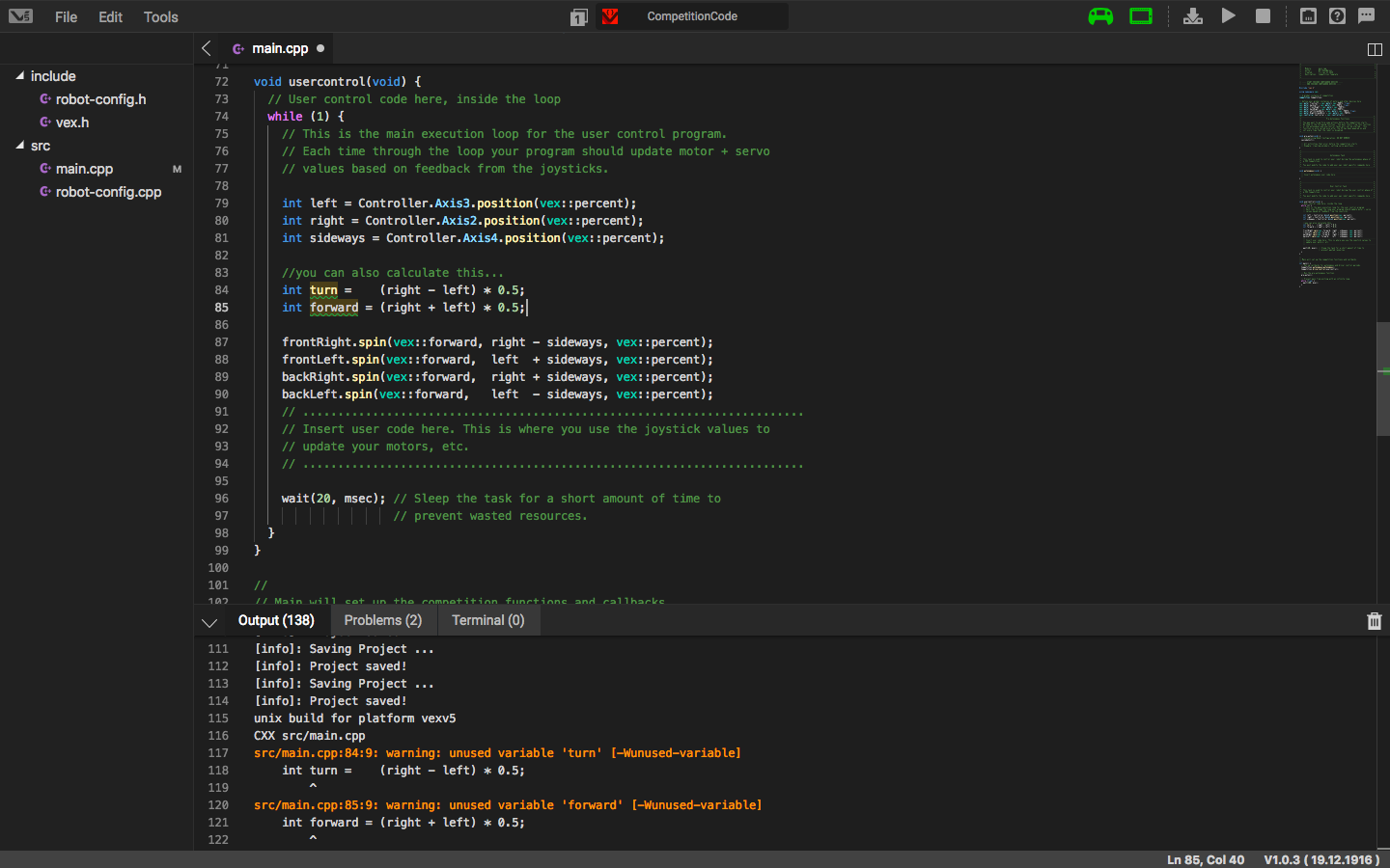

Our code:

Our output:
[info]: Saving Project ...
[info]: Project saved!
unix build for platform vexv5
CXX src/main.cpp
src/main.cpp:87:9: warning: unused variable 'turn' [-Wunused-variable]
    int turn =    (right - left) * 0.5;
src/main.cpp:88:9: warning: unused variable 'forward' [-Wunused-variable]
    int forward = (right + left) * 0.5;
2 warnings generated.

Based on the contents of the output tab, that code appears to compile fine, and I just verified that by compiling it on my system.
What exactly is the problem you’re experiencing with this code?

Could you please explain to me why this problem is occurring as I am almost certain this is the cause of the problem (since the forward and turn are not working and these are the ones popping up with the error)? And potentially how to fix it.
The warnings you receive
just mean that you are declaring two variables called turn and forward, but not actually referring to them anywhere in the program (hence “unused variable”).
I would suggest that you read the post I linked above and implement the described control scheme.

You first need to confirm that two left wheels spin forward if you lift your robot up in the air and push Axis3 control stick forward. Similarly, when you move Axis2, you should expect both right wheels to move in the correct direction.
If both of those check out and you still don’t have correct movement when you put robot on the ground, you need to ensure that mecanum wheels are installed correctly.
I can confirm that the wheels are composed properly along with the wheels you mentioned spinning when I move Axis 2 & 3
Well, if you can confirm that, while robot is lifted in the air, all individual wheels spin in proper direction when you push on control sticks and that the wheels are installed correctly, then what happens when you place the robot on the ground?
If it doesn’t move forward as expected, then the next thing to check is that all 4 mecanum wheels are contacting the ground evenly and that they all have identically geared (colored) cartridge inserts.
Other than that, if none of the wheels somehow have a ton of extra friction, I don’t really know what else it could be. You would need to provide a video footage of the robot not driving correctly with some detailed views of the chassis underside.

Hi, thank your for your help with this issue. Fortunately, we were able to fix it ourselves.
