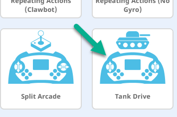

For Driver Control, directing the students to adjust the existing Tank Control (or Arcade) example from two motors to four motors a good direction? Or is there a better suggestion?
Tank Control:
The students would add a second Left Motor and Right Motor and they’re golden, right?
Nope, this is the way to go… this is why we provided those examples in the software in addition to building them in the Devices window.

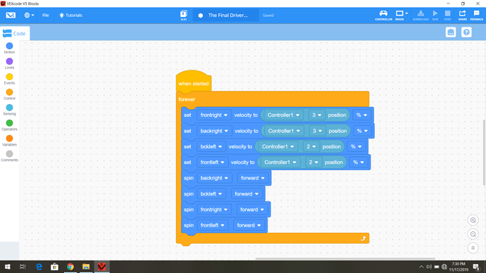

i know this is like a month later but here is the exzact code i didnt find anything here 2 useful when one of my sister teams needed help with this
So the code you are showing above was the solution? Or nothing has seemed to work? Just curious I have started testing yet. We are still in the building process.
Nvm, it looks like VEX finally upgraded vexcode to support a 4 motor drive train. Haven’t tried it yet though.
yes vex did upgrade to a 4w drivetrain yes that is the code that makes it work
