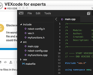

I’m wondering if i made a new file that had functions would work. So all my void functions stay in one file and all the actual execution using the void functions stays in another file. Would that work? And could that file import from the motor setup file?
Here’s an example, the files in the project look like this.
I created two new files, one in the src folder called myfunctions.cpp and one in the include folder called myfunctions.h (of course they can have any appropriate and meaningful names)
myfunctions.cpp just has one function that looks like this (just as an example)
// to allow access to SDK classes and class member functions
#include "vex.h"
using namespace vex;
// add two numbers and return the result
int
addtwonumbers( int a, int b ) {
    int result = a + b;
    return result;
vexfunctions.h has the function prototype, that lets the compiler know the functions name and what parameters it accepts but does not define the body of the function.
// declare the function prototype here so
// the compiler will understand it when used
// in other source files
int   addtwonumbers( int a, int b );
Then to use the function in main.cpp we could either include my functions,h in that file or somewhere like vex.h
#include <math.h>
#include <stdio.h>
#include <stdlib.h>
#include <string.h>
#include "v5.h"
#include "v5_vcs.h"
#include "robot-config.h"
#include "myfunctions.h"
now we can call that function from main.cpp (or any other source file) and the compiler will not show any errors.
#include "vex.h"
int main() {
  vexcodeInit();
  Brain.Screen.print( "2 + 3 = %d", addtwonumbers(2,3) );
project attached
