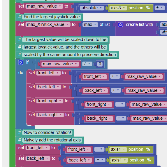

Looks like the screenshot is based on this public RobotMesh example:
https://www.robotmesh.com/studio/5be40c8ac8f17a1f5796cf57
Tried to stay true to the example and and not to deviate what they were doing. Didn’t have an Holonomic X-Drive to test out. So there are probably errors in it, but it’s a start and anyone with an X drive can troubleshoot and fix: Holonomic.v5blocks (42.3 KB)

I have check the code and I am really confused about the minus “-” on the joystick axis 1. I think joystick axis 1 should refer to the axis of rotation. If so, why there are two minus “-” on the joystick axis 1 for both the setting of front_right and back_right motor? I would be very appreciated if you could give me some instruction about that
I’m not exactly sure what you are asking so I’m just guessing.
The example that @gbr posted has some bugs in it based on order of operations. (I didn’t look further than the controller lines.)
The general code for holonomic is
LF = VSpeed + HSpeed + Yaw
LR = VSpeed - HSpeed + Yaw
RF = VSpeed - Hspeed - Yaw
RR = VSpeed + HSpeed - Yaw
However, block code only has two operand assignments: (a + b), (a - b), etc. The three operand assignments need to be grouped correctly to get the right output value. Using V, H, & Y for the equation of LR could have two groupings V - (H +Y) or (V - H) + Y. The first one is not the same as the base equation above. But the second one is. Just make sure you group the first two operands and leave the third one on its own. Note that this is what the RobotMesh example does.

What I meant to the axis of rotation should be in the same direction is based on the youtube video by Doug Klein regarding to the VEX Holonomic below. I think I do need to figure out what’s the difference between these two definition about the rotation axis
VEX Holonomic Drive by Doug Kleig
The difference is that the equations I posted are for the drives with left motors normal rotation and right motors reverse rotation. Right reversed is typical for skid steer which is most often used drive. Doing this makes the holonomic equations look similar to skid steer arcade.
The equations from the link are for all motors set to normal rotation.

Also of note is the link shows x-y control on the right and yaw on the left. But the robotmesh code and I think most other code have x-y and the left and yaw on the right.
As you get more advanced here is a link to a different way, from robotmesh, to code x-arcade so the input values from the controller don’t exceed the motor range.
