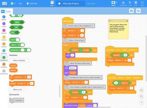

VEXcode IQ Blocks is a graphical drag & drop programming environment powered by Scratch Blocks. We added 100+ VEX specific blocks to make programming a VEX IQ robot easier than ever before. This allows students to experiment and explore programming without the complexities of compiler errors or a text-based language.

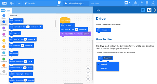

VEXcode IQ Blocks is supported on Chromebooks*, Windows, and Macs. iOS and Android support is launching in Fall 2019. New coding features, including the Drivetrain Blocks, allow new and experienced users to make robot movement easy. The new Devices Window also allows users to configure their robot faster than ever before!

Students can get their robot up and running with as little as one block. More experienced users can create fully autonomous competition robot programs. All features of every VEX IQ sensor is available to make your robot do more than ever before.
