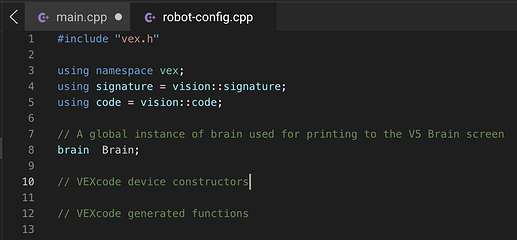

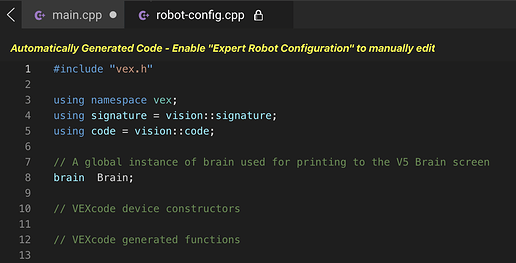

With that being said, the VEXcode team has heard our user community and wanted to respond as soon as we possibly could. The VEXcode team will be releasing VEXcode V5 Text 1.0.1 today - this release will add a feature to disable the Graphical Robot Configuration tool and allow users full control of their projects. By enabling an “Expert Robot Configuration” flag from the project settings, users will be able to disable the Graphical Robot Configuration tool and have full write access to the “robot-config.cpp” and “robot-config.h” files. This will allow more advanced users the ability to create and configure devices as they have in previous versions of VEXcode Text. Users will also be able to delete these configuration files and create their own program structure as they see fit.
New Settings:
Expert Robot Configuration Enabled
Robot Configuration Files in Standard Mode
Robot Configuration Files in Expert Mode
