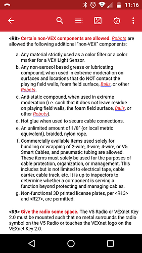

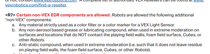

Also, does anyone know why it’s legal in EDR but not IQ?
it’s not. in the vrc manual they specifically state that wd40 is illegal. other lubricants are legal in vrc tho, but aerosols and super thick ones aren’t
edit: i might just be straight up wrong at this point but i had thought i’d seen something in the lubricant rule (R8b) that specifically mentioned wd40 in the TT manual and assumed the rule carried over to this year, but i just looked in the CU manual and don’t see any mention of wd40, but the other parts of the lubricant rule are still there. weird
The main reason for restricting lubricant types for VRC is to reduce the chance that it could leak on the field tiles and damage/alter their properties permanently.
For IQ, lubrication is, probably, not necessary because plastic IQ parts have low enough coefficient of friction, robots weight less, and in general you don’t push your designs to the edge powerwise as much as VRC does.
Also, WD-40 is not recommended for plastic parts anyways, since it contains solvents and may damage them in the long term.
You can view the WD-40 Material Safety Data Sheet here. It states less than 35% of it is “petroleum base oil”. The rest is naphtha solvent (Gasoline, more or less) and carbon dioxide propellant.
It’s not a terribly good lubricant, and spray lubricants are explicitly banned by rule R8b, as Ethan5956F noted, but it does have some lubrication properties.
It actually depends. There rules say:
Some is aerosol based, but I have purchased a version of WD-40 that isn’t aerosol based.
In general, take a minute to verify that the rules say what you are saying they say. The rules don’t even mention WD-40, but you said that it is specifically stated. If you get in the habit of actually quoting the rule, then things will be more clear in general.
you seem to have missed this part. I made this edit within like 10 minutes of my original post. looked a little further afterwards and it’s not in the tt manual either, so it seems i was just imagining things. regardless, my point stands.
in general, take a minute to verify that the person said what you are saying they say. if you get in the habit of actually reading the quote, then things will be more clear in general : )
