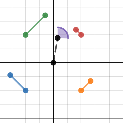

So I thought with the popularity of X-Drives this season. (And it being my favorite drive :wink:) I’d release this fairly simple Desmos graph that calculates the exact percentage to spin each wheel at in order to move in a certain direction. (Measured in radians)
Each colored line shows which direction and how fast each wheel should spin to move in exactly the desired direction. The black dotted line shows the direction and how fast you would move. (Motor speeds are scaled for maximum speed) Notice that you move faster when traveling closer to straight forward and backward than when you move diagonally. I also added a feature to prioritize rotation over movement. The purple arc indicates how much it will turn.
In the variables folder, adjust:
  • T to change the target movement direction.
  • R change rotation amount- 1 to only turn right and -1 to only turn left. Anywhere in between to have a balance between the two. (For instance, 0.5 would evenly distribute motor power for moving and turning)
  • S to change the speed- all motor speeds are automatically scaled so that the fastest one is equal to S. In actual robot code, this is what you would adjust to slow it down for something like a PID loop.
Please feel free to use these equations in your code, but don’t just copy them down, try to understand how it works.
>Desmos link<

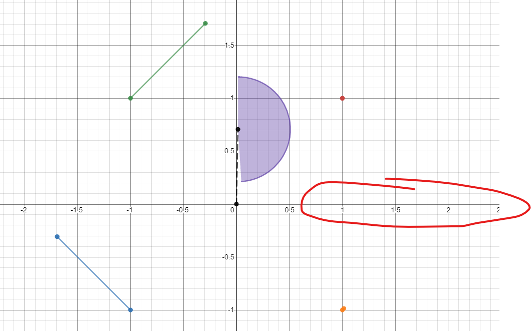

Ok, I absolutely promise that this might be the last update. I realized that the calculations for slight turns, while looking accurate, were completely wrong. here’s the new link again. Sorry for spamming my own thread.
This is pretty neat. I’m curious though, where were the calculations derived from? I would imagine you could also combine this with a turn PID because the chassis has two degrees of freedom. So, theoretically, you could also change the orientation of the chassis while it’s moving in a given direction, correct? (via combining different PID controllers)
Edit: I’m a bit confused overall about what the graph represents. More specifically, the “R” term. When the robot is moving in a given direction while turning, the wheel velocities change over time correct? Does this means the displayed wheel velocities for the given “R” variable aren’t constant? What happens when the robot arrives at the target orientation? Shouldn’t the wheel velocities change in response to that.
TL;DR can you better explain the “R” term?

The calculations were basically derived from the fact that the movement along one diagonal was completely dependent on the movement of two opposite wheels, and independent of the other two, and vice-versa for the other diagonal axis. Because of this, Finding the motor value for just moving with no turns is simply finding the x-value of a diagonal (or a point on a circle) but rotated 45 degrees one way or the other. (since it’s in radians, that’s why you see the “+pi/4” or “3pi/4”) in the cosine functions defining P1 and P2. Then to turn, I simply use linear interpolation to choose a value somewhere in between the initial value and 100% in the direction of the turn.
Sorry for the wall of text, I tried to boil it down a bit. =)
Ok, I’m just now seeing your edit, so I’ll explain the ‘R’ term a bit more. Basically, it decides how much to prioritize turning over moving, and its sign determines the turn direction. So if it was R=0, it completely ignores it and just moves. If R = 1 or -1, it completely ignores the moving calculations and just turns. For something like 0.25, 3/4 of the value would be determined by moving, and 1/4 by turning. Does that make any sense?
To drive and turn at the same time, you’d have to figure out both the distance to your target position and the distance (circumference of turn) to your target direction, and then set R to the ratio of the rotation target error to the position error. There are other ways to do it, but this is how you would get it to arrive at the location and face the direction at the same time.

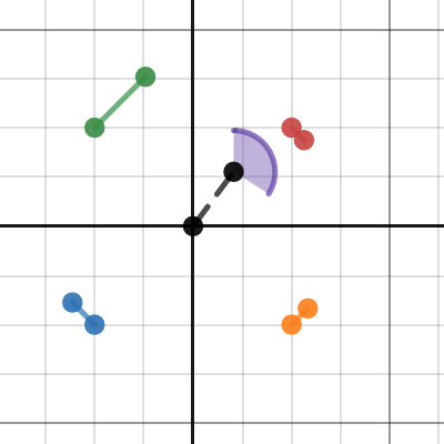

So what does this have to do with turning? Well, the ‘R’ (or at least the absolute value of it.) variable is acting as the linear interpolation factor just like ‘L’ was earlier. The speed the motor would move at to just turn is in place of V1, and V2 is replaced with either 1, for turning right, or -1, for turning left. Keep in mind that this is calculated separately for each motor. Here’s a table to make it more clear:
R value resulting motor speed
0 ignores turning speed, just moves
0.25 mostly moves, but adjusts speed by 1/4 to turn
0.5 even balance between moving and turning
0.75 Mostly turns, but adjusts speed by 1/4 to move
1 only turns, ignores moving speed

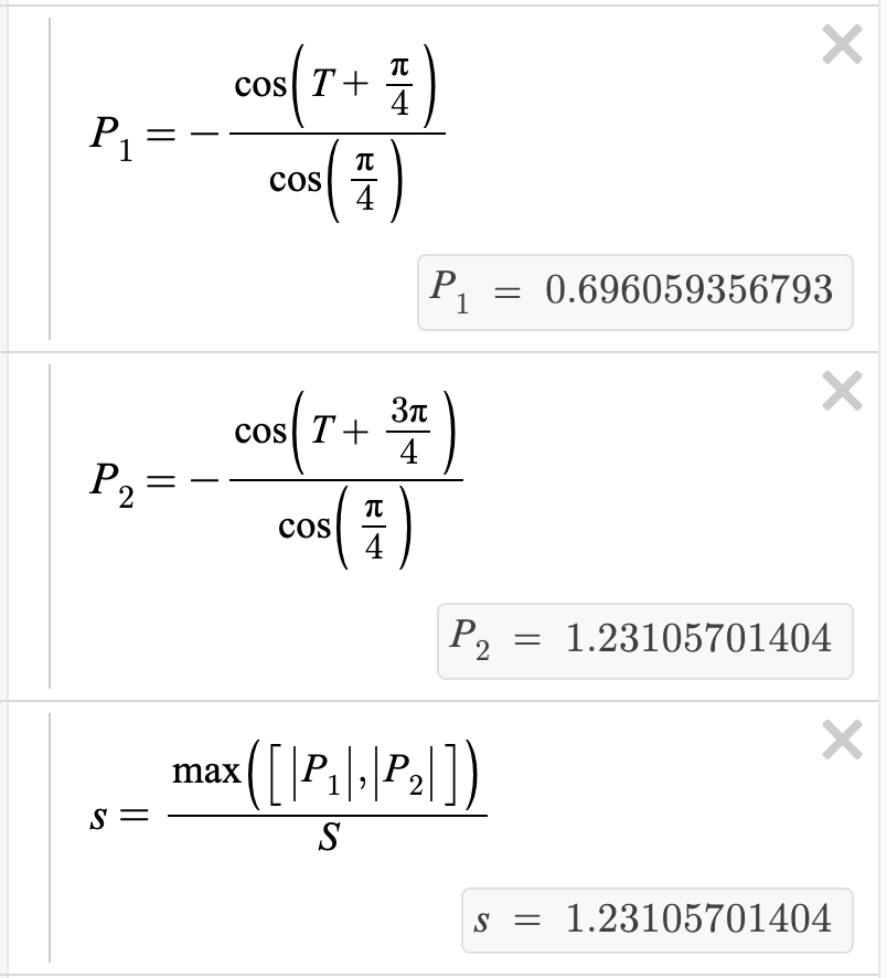

P1, P2 , and s
P1 and P2 are the values calculated for just movement. P1 is for front right and back left wheels, P2 is for the front left and back right wheels. These serve as the “V1” values when interpolating from movement to rotation.
s is set to the larger of the two values P1 and P2 so that both can be divided by s later. This ensures that the largest P value is equal to 1 (or to the global var S, since s gets divided by S)

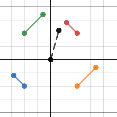

Edit: I added in @theol0403’s simplifications and also fixed a visual glitch where the black line was too long. Here’s the current version.
