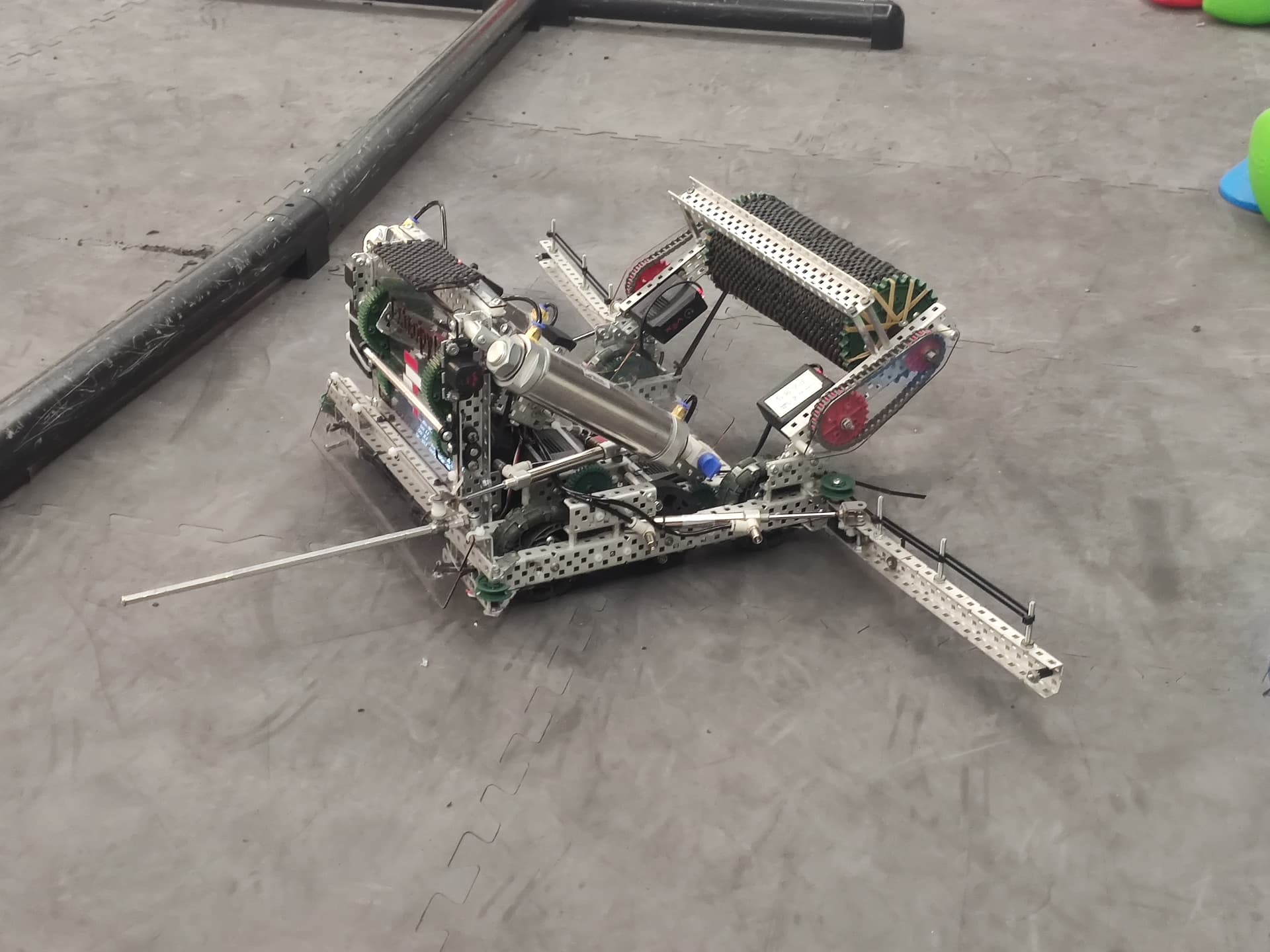

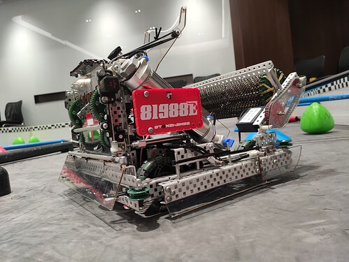

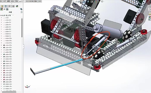

We are proud to show you the robot we designed. This robot won the championship of the high school Robot Skills Champion and Excellence Award in the just-concluded competition in Hangzhou, China.

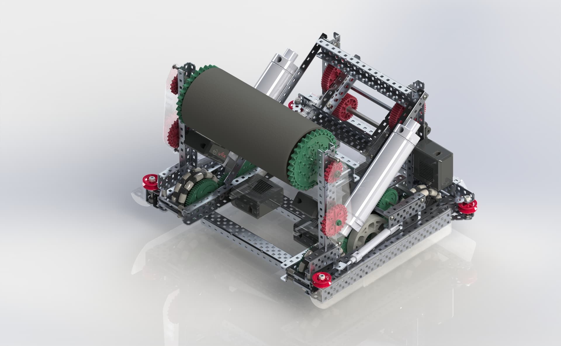

Renders of our Robot:
  • 66w 360RPM 3.25in Chassis
  • 11w 300RPM Intake
  • 11w 60PRM Cata
We use a lot of PC parts to make the robot, such as our cata and intake, to lighten the structure as much as possible and make the robot more delicate. Since it is mainly designed for skill challenges, we did not design climber for this robot. but the climber will added later.
It is worth mentioning that this robot was made by our team in Ri3d one week before the competition, and all optimizations and programs were completed within a week, so that it can work normally in the competition.
If there are any questions about the robot, feel free to post them below!
How reliable is your matchload arm and can you send a video of it working if possible? Thanks in advance.
You can watch our skill video, 44 matchload take about 26 seconds to complete, I think this is currently a relatively reliable cata.

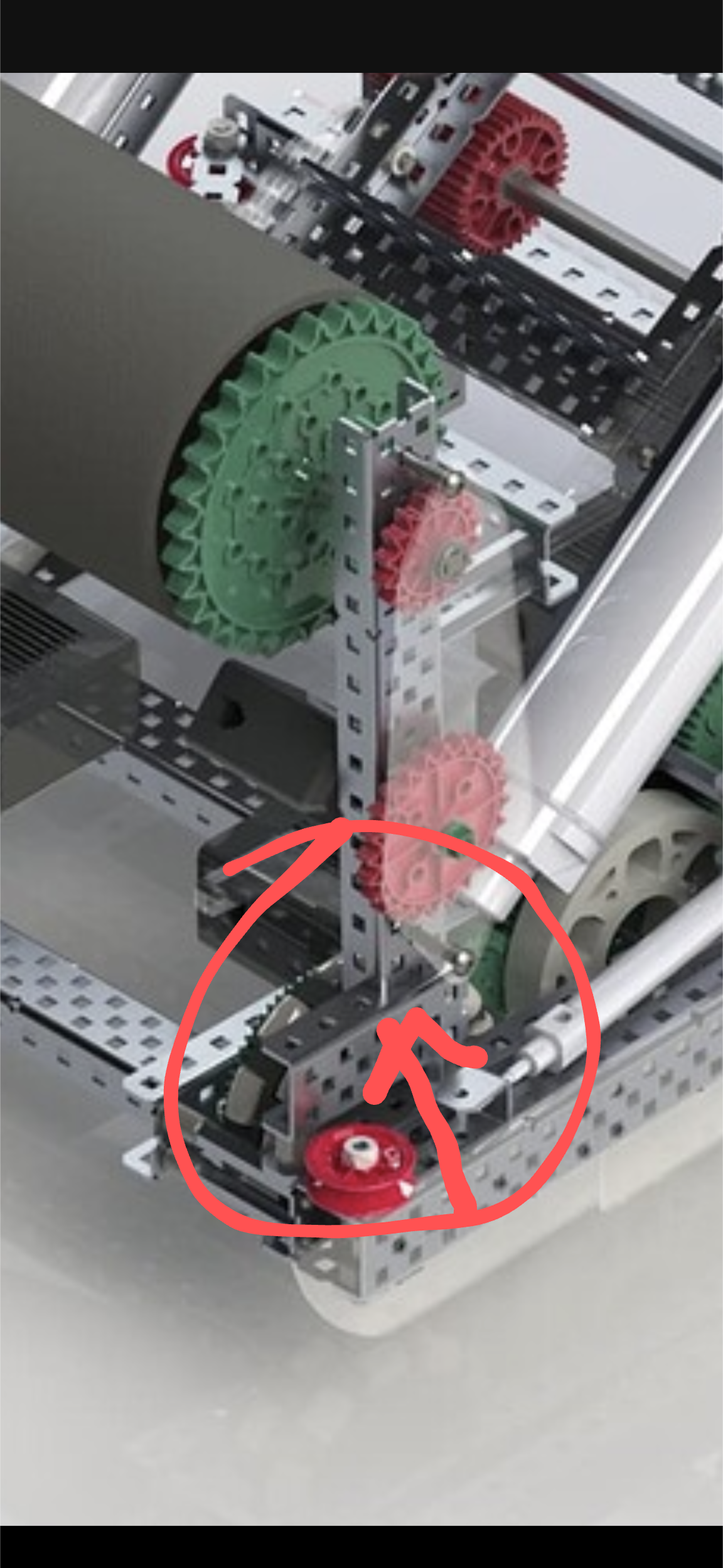

I have a question, could you explain this? My team is building a similar intake and that part of the robot has stumped me.
Thanks for all the wonderful info!
There are two 5.5w motor on the triball intake, instead of one 11w motor, I am curious as to why that decision was made? Could it be due to consideration of reliability perhaps?

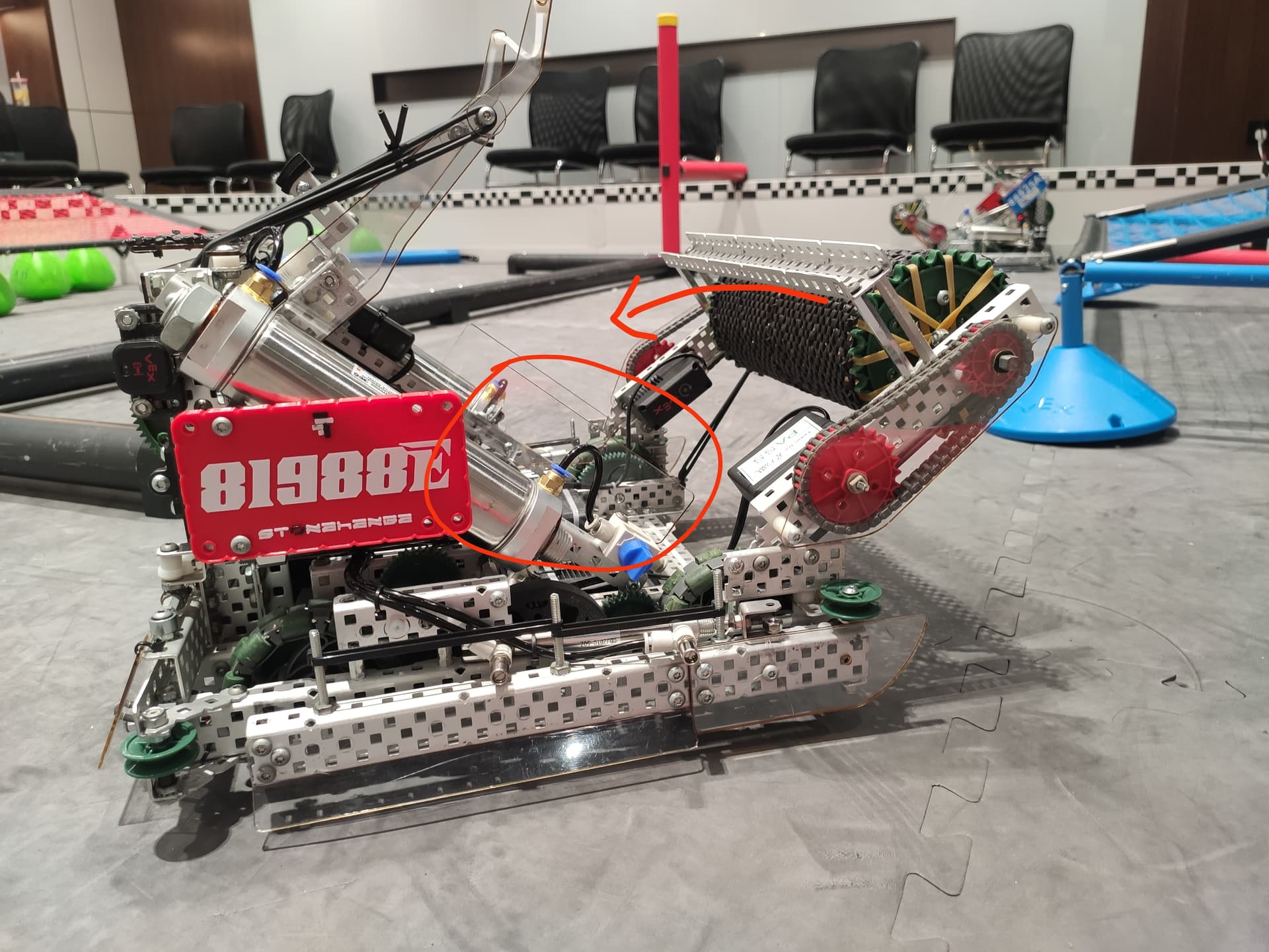

Sorry I wasn’t specific but I mean the standoff arm on the back of the bot that I assume is used to pull out the matchload during the autonomous period. Unless that arm is used for a different purpose?
Yes, it was made for the AWP, sorry for not showing the cylinder in the previous renders, in actual production it is powered by a cylinder that unfurls and hooks the Trilball out during the auto period.
Since our team is designing a new robot, this robot has been dismantled and cannot provide you with a video of it Working
First of all, if we use an 11w motor, the intake will collide with the PC.
Secondly, we use the chain to drive the intake. If we use 11w motor, we can only use one side of the chain, if it is damaged, our intake will not work properly, using both sides of the drive can solve this problem as much as possible.
Another small detail is that since the whole intake is lighter, using two 5.5w motors can make the center of gravity of the structure more balanced.

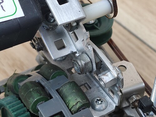

If what confuses you is the connection method, we first use a K-type nut to fix the shaft, and then install the intake on the shaft with Nylon Hexagon Nut so that it can rotate on the shaft. (The shaft is a screw)
If you are confused about the strength of the connection position, our team is also confused about this and try to solve this problem in the latest design of the robot, but at present, we do not have a perfect solution.

What is the purpose of this pulley thing on the wing joint?
I’m pretty sure that’s to let the robot slide along the walls easily, but that is a good question.
How does the intake go up and down as I don’t see a visible motor to pull it up or down
There is no motor to pull the intake up. The intake is on a hinge, so when they run into the goal, the intake moves.
It made for let the robot slide along the walls.
But the reality is that it doesn’t seem to be of much use.
Micahy is right.
It only made for our robot can go into the goal and put the triballs into the goal easily.
