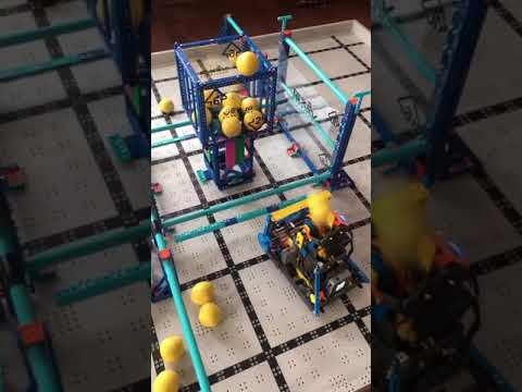

Ooooo also check out my hood lfywheel :rofl:
Ok I didnt use flywheel weights i just strapped a bunch of gears around the flywheel and that worked pretty well. With a single motor the recharge time was <0.5 seconds.
also since the high hang dump bot got killed a catapult seems to be the meta because flywheels in general are just bad for squishy balls that dont have a well defined shape
