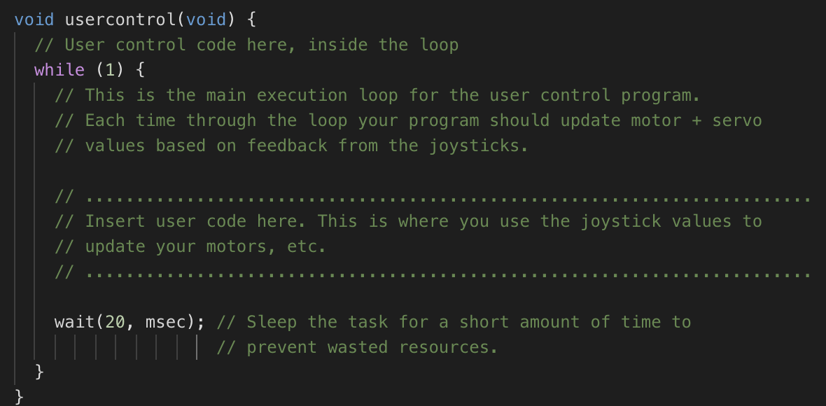

Coding to Drive:
Everything in green is pseudocode. This means it is just instructions for humans that robots ignore. It is either done by putting // at the start of the line or having the text /* in here */
You will want to scroll down till you find this section:
You will write all or your driving code inside the while loop. There are two main types of drive code, arcade and tank. Here is the basic code for both on a 4 motor drive with explanations. Feel free to make 2 programs and try both.

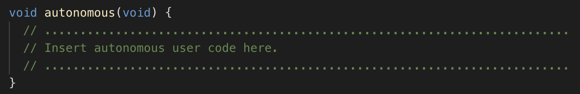

Coding an Autonomous:
Every match begins with a 15 second autonomous period. It is crucial to have an autonomous as there are many benefits. It gives a point bonus to whoever wins, it gives them a headstart on having more objects scored, and it can give win points.
To start coding, find this section:
You will also want to sort your motors into groups with these commands right after “using namespace vex;”. It is very easy to do. Here is an example of the 2 motors on the right side of the drive being combined: “motor_group rightDrive(rightFront,rightBack);” You can refer to the motor group just like you would any motor, but it won’t autofill.
Another couple commands you will want to use are “wait(NUMBER, sec);” “MOTORNAME.setVelocity(NUMBER, percent);” and “MOTORNAME.spinFor(NUMBER, degrees);”
As a general rule for autonomous, don’t move your drive any faster than it needs to. The faster your drive moves, the more likely it is to slip and lose accuracy. Don’t forget to test your auton too! Here is an example of a code that would drive forward, lift something, and drive back:
