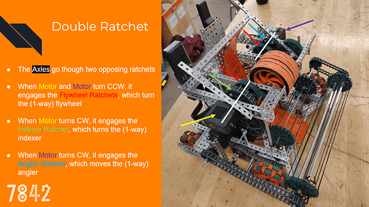

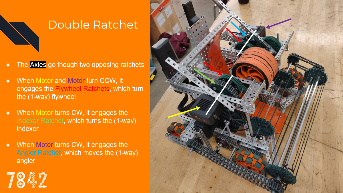

Possibly OP Motor Sharing Mechanism

Nice! Just curious as to how much strain is put on the motor when changing directions, but other than that, I really like it.
I’m just wondering since I’m planning on doing something similar, where the motor needs to change direction just as much.
Well that’s a very nice and clever design, but with three ratchets, it will generate as much noise as the amount of data saved by your re-run program :slightly_smiling_face:
Making it, possibly, one of the most annoying robot designs out there…
And where there is noise - there is energy loss and additional load on the motor that reduces effective power output for the flywheel.

@technik3k brings up a good point. Perhaps something like this could be a more efficient solution to make the shared mechanism spin in only one direction.
Motor sharing is always a good way to score points with judges while making good use of motors =) . Double ratchets can be very useful in games like this where you only need things to rotate a certain way.
In Turning Point we had a similar concept with our flywheel bot, where we used 2 motors to power a 2-motor flywheel, an indexer, and an angling hood. In total, we used 7 ratchets :smile:. However, Jacob designed some pretty nice custom ratchets so the bot was nice and quiet.

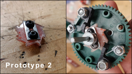

Can you share this? I’m intrigued.
pretty slick custom ratchets.
Yep, it’s all explained and linked to in my post.
You can even find the link to the online challenge entry and CAD files :wink:
Wait, that’s 3D printed. How did you make it so that it was VRC legal?
looks like it’s polycarb.
The entry for the online challenge was a 3d-printed part, yes. However, for our robot we used stacked layers of lexan.
Fun fact, 6 out of the 7 ratchets had 3 pieces of hand-cut lexan layered together. You do the math to find out how much time that took jacob to cut :sweat_smile:
I don’t even need to. I’ve seen layered lexan done other places, and I know how long it takes.
I am interested in seeing if anyone can design/build a ratchet using a 36T gear rather than a 60T gear.

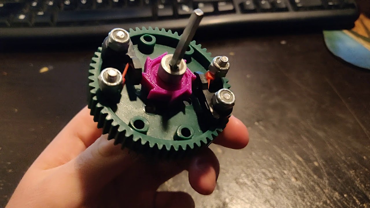

Here is a demonstration of the ratchet gear:
On our robot, we used 4 of the half-cut pillow bearings instead of 2, which made the ratchet able to withstand a lot of force (while still being quiet). This was needed for our flywheel which could accelerate quickly with 2 motors, and with only two points of contact the ratchet would sometimes cause the pillow bearings to collapse.
If you look at the picture of the bot above, right here:
there are two opposing ratchets facing each other, which was quite impressive space management.
I designed a low precision ratchet quite a while ago that was able to fit within the profile of a 36 tooth, (leaving all teeth available to mesh and turn with another gear) but took up quite a lot of shaft length, not nearly as compact or as precise as Antichamber’s however
