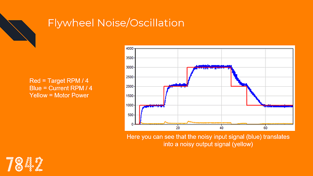

However, feedforward can’t do all the work. The velocity might not be linear to output power, or there may be some friction or other interference. This is where P (Proportional) comes in. P, supported by F, does the rest of the work by nudging the flywheel power in the right direction to completely reach the goal. For this to work, P must be very high, leading to another problem: oscillation.

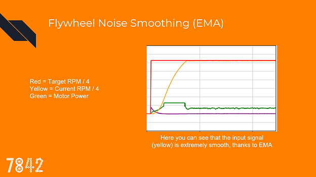

The signal coming in from flywheel velocity calculations are quite noisy if you want them to be up-to-date. When the algorithm sees this noise, and kP is high, this translates to noise in the output signal. This means the motor starts oscillating, which translates to real flywheel oscillation. This translates into an even more noisy signal going into the PID, causing a vicious cycle of oscillation.
Signal EMA Filtering
To solve this issue, the input signal needs to be smoothed. For this, I use an EMA (Exponential Moving Average) filter.
EMA takes the flywheel reading over time and strikes a balance between taking into account the new reading and keeping the old one. If you overuse EMA, it will cause the signal to be unresponsive and outdated, causing more oscillation, so it is important to use just the right amount to smooth noise.
Now that EMA causes the input signal to be smooth, the output power will also be steady. This is exactly what we want when controlling a flywheel: smooth, steady power. Now that the input noise and oscillations are damped and filtered out, I can use a large kP gain to be as precise as possible without fearing oscillation.
Note: I could also try to use the I term for more accuracy, but I have not had a good experience with it, as it likes to introduce a lot of oscillations into the system. In my algorithm, I have not implemented I.

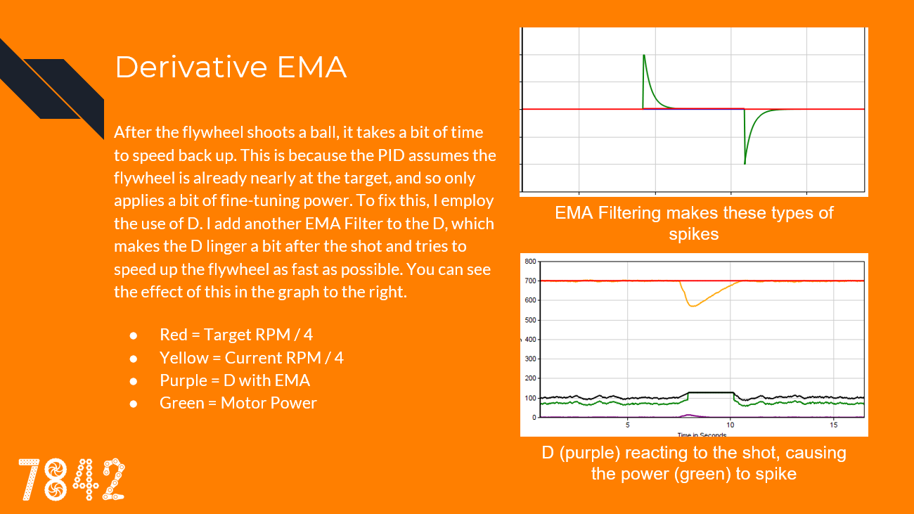

Derivative EMA Filtering

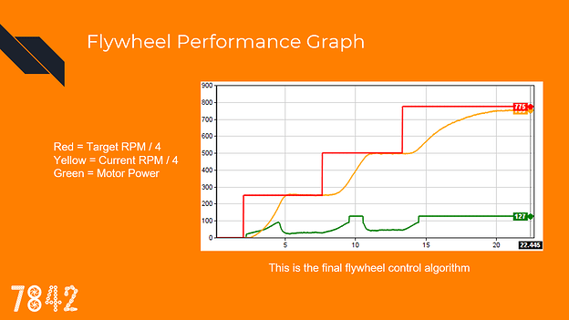

When the flywheel shoots a ball, I want the flywheel to recover as quickly as possible, so that the next shot will be consistent. That means I want the motors to spike to full power while the ball is being shot, not once the flywheel has slowed down enough for P to kick in. To do this, I use the D (Derivative) term. D is simply the rate of change of the error, applied to the motors to try to fight against that rate of change.
I don’t just want the D to kick in while the flywheel is slowing down, I also want it to linger a bit after the shot to provide an extra boost. To do this, I also apply an EMA filter on the D. Filtering D is common practice, as it makes D have time to affect the output instead of being there for only a few timeslices. Without filtering, it only acts against the change of motion exactly when it detects it, so in the case of a flywheel, when you shoot a ball, the only effect D will have is exactly when the flywheel is slowing down. With filtering, D lingers a bit after the initial high rate of change.
As you can see, using a filtered D allows the flywheel to resume target speed as fast as possible.

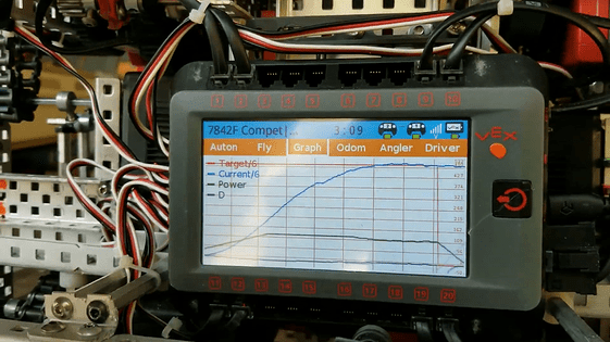

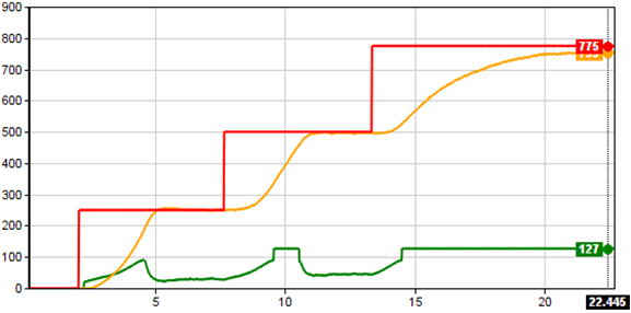

To properly tune the flywheel constants, I needed a solution that did not involve redownloading the code every iteration. With RobotC, I could directly tune the constants using the debugger, but with PROS V5, there is no such tool. This is why I designed an LVGL tuning utility.
V1:
V2:
I also made a graphing utility to visualize the flywheel performance:
V5 Flywheel Datalogging
As you may know, the programming solutions V5 do not have any of the remote debugging features of RobotC. While I did have the GUI graph, I wanted a solution that could record in the background and report to the computer.
Thus I wrote a utility that saved a log of all the flywheel information in a CSV on the SD card. Each time the code ran, it would save a log of the flywheel state. I could then read these files on my computer and import them into graphing software such as R, Excel, or mathplotlib.
I kept this logger running in competitions and even worlds, so if something happened to the flywheel we could go back and look at its log, which contained information like temperature. I recommend using the SD card to store information, as it can be a useful tool. You can also use a third-party library to do the CSV writing and file management for you.

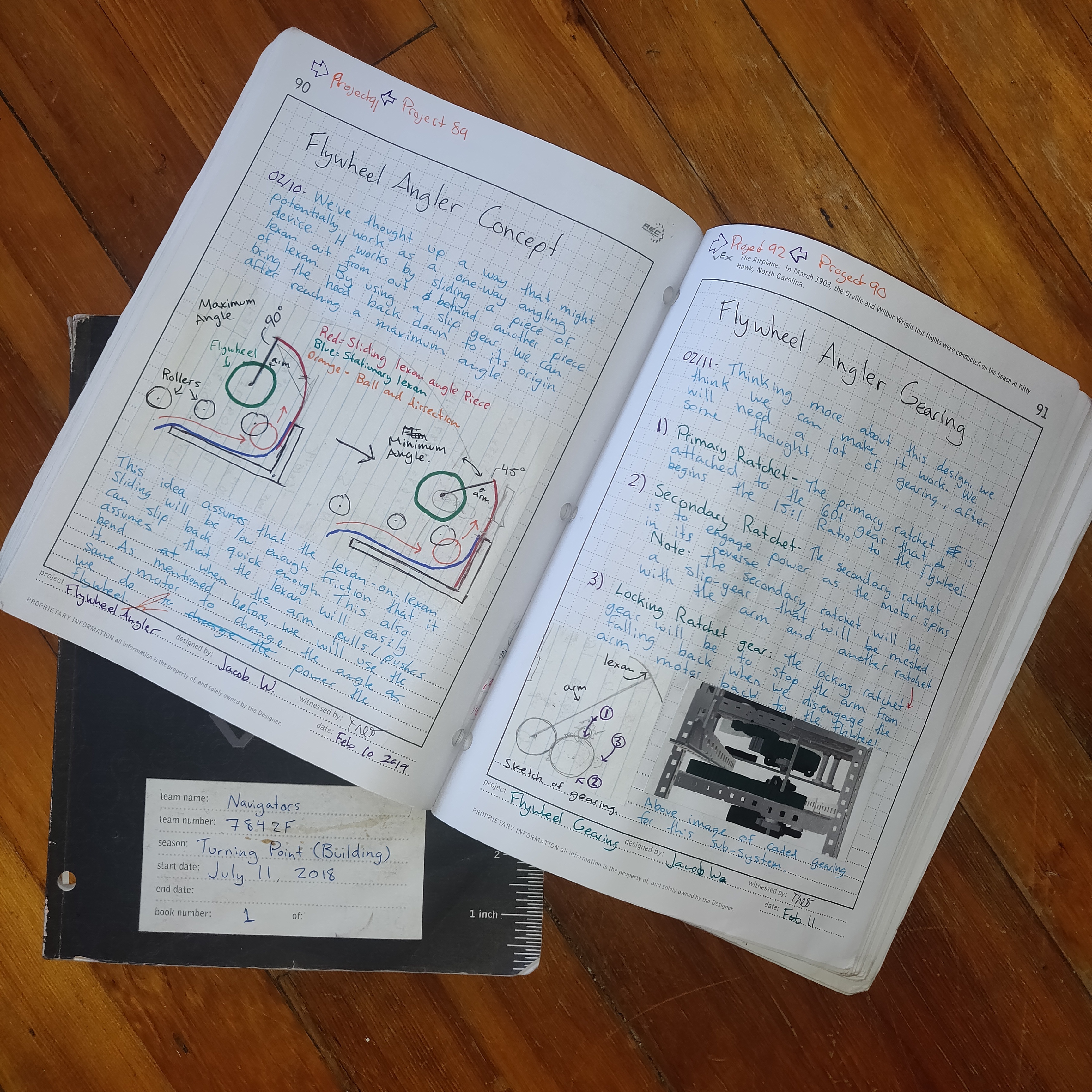

For our third robot, the one we took to worlds, we made an angling flywheel hood. It took us months to perfect, but it worked well in the end.

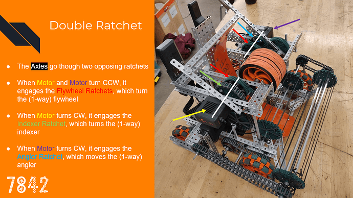

Double Ratcheting System
Our worlds robot had a 2m flywheel. However, we also wanted a 4m base, an intake, an indexer, and an arm. To achieve this, we had to use a motor sharing system. Since the flywheel motors only spin in one direction, we took advantage of the other direction by using a double ratchet system. We could then power another subsystem when the motors spun backward. With this system, we were able to use 2 motors to power our flywheel, indexer, and angler.
We needed smaller and more compact ratchets than was provided by VEX, so Jacob designed a custom ratchet and submitted it to the CAD online challenge: 7842F - Improved Ratchet Gear | Online Challenges
He then expanded that system by making a compact double ratchet.
The angler is ratcheted so it can only be moved forward. When the angler reaches the maximum position, a slip gear brings the angler back to the resting position.
Operation
Here is the flywheel system’s typical routine:
  1. Both motors spin CCW and work together to spin up the flywheel
  2. When a shooting angle is requested, the angler motor spins CW to engage and move the angler, cycling if needed. The indexer motor maintains the flywheel’s speed.
  3. When the angler is at the desired position, the angler motor resumes powering the flywheel.
  4. When it is time to shoot, the indexer motor spins CW, engaging the indexer and shooting the ball. The angler motor maintains the flywheel’s speed.
  5. The indexer motor resumes powering the flywheel.
  6. If a doubleshot is selected, the angle for the next flag is requested and steps 2-5 repeat
  7. Both motors continue powering the flywheel until the next angle adjustment or shot

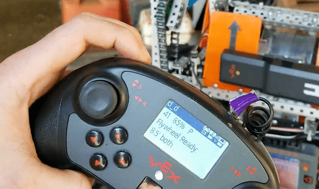

I also have a display on the controller that gives me some useful information:
It tells me which distance and which flag is selected, whether the flywheel is at target velocity, the time left in the match, the robot’s battery, and the controller ID. This display was useful for driving at competitions. A copy of this screen is also on the master controller.

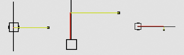

Adaptive PID Seeking
I posed this question: “If the robot is locked to its current heading, so it can only move forward/backward, how can it move in a straight line to get closest to the point as possible?”.
If the robot was perpendicular to the target, the answer would be 0. But as the robot rotates to face the target, the answer becomes more and more. Here are some images illustrating the question (the answer is the length of the red line):
With the help of others, I was able to implement the math for this. When doing distance PID on the output of these calculations, the robot was able to move much more efficiently. I also had to implement some logic to be able to drive backward. The reason this algorithm works great for settling is that if I turn off the angle PID when the robot is a certain distance away from the target, the adaptive distance PID brings the robot to a settled stop, giving a negative signal to back up.
To test this algorithm, I (with some help) made a javascript simulation. You can see how the robot prefers turning over driving, and how it settles smoothly.

EMA Filtering
However, I noticed a problem with the vision sensor. The objects would often flicker and wobble, which I was worried would translate into oscillation and problems with filtering. So I decided that I needed to EMA filter the objects. This is a more difficult task than one would think, as I can’t simply filter by object index because the objects are ordered arbitrarily (or by size, not position). I won’t get into how I managed to do it in this post, but basically, I looked at the objects over time, kept track of where they were, ordered them, and then correlated the objects in a new snapshot with the previous snapshots. I could then EMA filter them. To develop this system, I used the LVGL simulator to test on my computer. If there is interest for me to make a guide on how to set up the simulator with C++, let me know.
I have had an interesting relationship with the vision sensor throughout the season. Despite all the work I did with it, I never got it to the point where I was comfortable using it in competition. It was just so frustrating to use and unreliable. Hopefully, VEX will fix the firmware for the vision sensor and it will become more practical for use. When I have the time I will keep working on my library so that it can be eventually released.

Engineering Journals
Throughout the season Jacob did an amazing job of documenting our progress. He made two engineering journals, one for project management and ideas, and the other for linear build documentation. If you are interested in our design process, ideas, and more of our robot, check them out! They have earned us awards at every competition we have gone to, except for worlds, because unfortunately there our judging was rushed. However, later we were approached by the pair of judges that we were able to give our full presentation to and were complimented on our presentation.
I hope these journals are a great resource and that they provide a good learning opportunity! My favourite pages are the last 40 of the project journal.
7842F 2018-19 Build Journal - High-Res.pdf (35.0 MB)
7842F 2018-19 Project Journal - High-Res.pdf (57.2 MB)
There are higher and lower-resolution versions, and the original images, available here. Enjoy!

hey could you give a brief description as to how your lvgl for odometry will help users in tuning their odometry?
Like I said, odometry is hard to tune. It takes a lot of iterations of fine-tuning to get it right, and is prone to error and drift. Everything needs to be working perfectly together, or else the whole system crashes. Thus, it is important for the tuning and diagnosing to be as seamless, fast, and efficient as possible.
What most people do is print information to the terminal. While it works, it is quite awkward and hard to visualize. What I mean by this is that it takes considerable effort to analyze and figure out what the stream of numbers coming in mean. It is just easier to have a visualization.
Having the LVGL visualization makes it faster to get information. You can quickly see if the sensors are working, if the wheels are working, etc. You can drive the robot forward, and directly see if the robot is drifting on the screen. It is useful for tuning constants, because you can move the robot and watch the robot on the screen do so as well, and see if it matches what you expect. If the visualization is not precise enough, you can use the numbers printed on the screen.
TL;DR It provides a faster way of visualizing the odometry and troubleshooting problems, as it readily gives visual feedback that is a hassle to get otherwise.
Does this answer your question?
yes and i had another question, are we able to use this with our own odomentry system and not using your api?
Because i have my own way of getting orientation and x-y coordinates
Yeah, you will probably have to edit odomDebug’s code for it to work with your format.
Soon I’m probably going to change how it’s structured so it can work with more formats.
Right now, it uses OkapiLib v4 beta’s odometry system, which will probably be released soonish.
You can download the beta version of OkapiLib v4 from its GitHub releases.
If you wanted to, you could inherit your tracking system from OdomChassisController, which would make it compatible with my code as-is.

I had a chance to read through all details one more time…
First, I was trying to understand if your flywheel control algorithm is a continuous (textbook definition) PID, where everything is controlled in a smooth manner, without artificial jumps, vs the multi-segmented approach, where if() statements introduce discontinuity.
For example, your 7842F-Alpha-Code-RobotC repository has such if() statement, but in V5 code it is essentially a nop-statement
Then I got lost trying to decide which of the features I like more:
demonstrated at 3:35 in this video: https://youtu.be/iW4RlnHbDrY?t=215
or the Vision Sensor instant visualization and filtering:
Please, don’t wait until the end of the season to release the code. :slight_smile:
Thanks for the compliments! I know it takes a bit of time to read :slight_smile:
For the flywheel PID, I believe it qualifies as a continuous, textbook PID. The algorithm can theoretically attain any desired velocity, it does not have a designated velocity that it operates best at.
I don’t think the two pieces of code you linked do what you think. They simply favor the D to one direction.
In this case, I just wanted the D to react to the flywheel slowing down, but I did not want the D to react to the flywheel speeding up. If the flywheel suddenly accelerated for some reason while it was running at target velocity, the D’s natural response is to cut the power.
However, a flywheel takes more effort to speed up than it does to slow down, and a flywheel’s natural bias is to slow down, and our flywheel was ratcheted making it impossible to forcefully slow down. Because of this I wanted the PID to react less aggressively and only lower the power a bit if the flywheel overshot, allowing the flywheel to naturally slow down and settle at the target velocity instead of overshooting the other way and slowing down too much. I also didn’t want the D to interfere with ramping up the flywheel.
For the RobotC version, I scaled down the D when it was below 0, and for the V5 version I cut out the D completely when it was below 0. Apart from that, the algorithm is linear and would have a smooth uninterrupted output signal if the target velocity was slowly increased.
I hope this clears things up.
