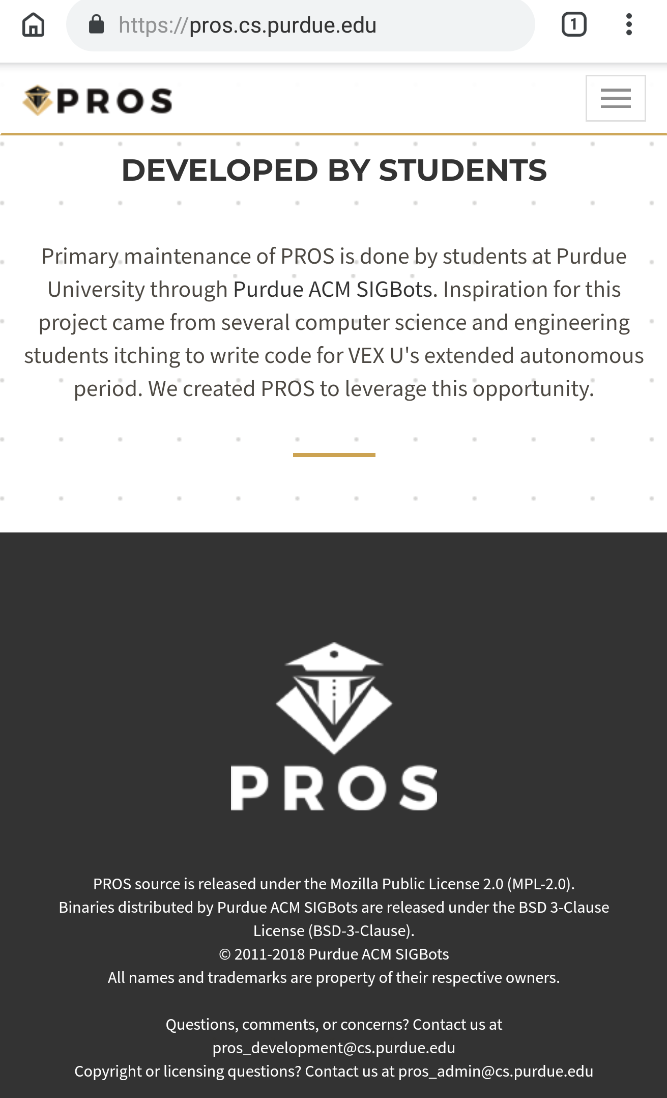

No, it’s not. PROS stands for Purdue Robotics Operating System.
Actually it’s Purdue Robotics Operating System:
Edit: Darn it ninja’d
Nope. While originally named that a long time ago, they have no official affiliation with Purdue, so they changed their name a while ago. Ask @hotel
I do not. PROS is currently using LVGL 5.1, the latest release is 5.3. Canvas support is included in 5.3.
Work is currently underway to upgrade LVGL in the PROS kernel. It is marked for the 3.1.7 release milestone, which is the next release.
Have you seen this example? What type of problems are you having with LVGL? I will agree that the styles are a bit hard to figure out and I did need to work together with the coders to figure them out.
I’m trying to get my programmer(s) to release their full LVGL GUI which allows for 24 autons and a full text display using a printf like command. Is that something you are look for?
I’m assuming what you say is true since @hotel liked your post, but I’m confused as to how they have a purdue.edu subdomain and purdue.edu subdomain email addresses if they have “no official affiliation with Purdue.”
Yeah it’s more like we just didn’t want to deal with any hoops involved with continuing to use the Purdue name, not that we specifically have no affiliation with Purdue.

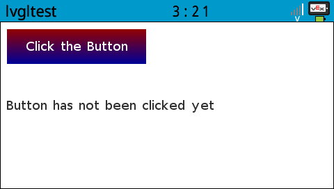

Just for fun, here is lvgl running from VEXcode.
tmp1
Not that hard to pull in the source and build
perhaps I will just build you a static library if you really want to use this.
demo code for the button came from here
https://team81k.github.io/ProsLVGLTutorial/
