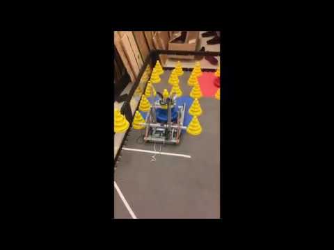

Team MCCC robot reveal: the Pneubot, zero motor drive
Inspired (accepting the challenge) from this thread: One Motor Drive?
We present the first VEX legal zero motor drive robot: the “Pneubot”
Videos and pictures here: Pneubot - Google Drive
Technical details: the crankshaft is powered by a pair of double acting cylinders offset by 90°. A V5 rotation sensor provides feedback to the brain to actuate the solenoids. The timing is mechanical, just like on a car engine.
This little robot has become our new example pneumatic trainer, since it contains almost every pneumatic component, along with code on the brain (PROS).

Well, it goes about 20’ on two full air tanks…

This is awesome I wanted to make one of these but it has no practical operation.
It has no use for competition, but it is a practical pneumatics trainer for the newer teams in our organization.
