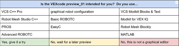

Please use this thread to post your questions and comments. Your feedback and ideas will be used to influence all future development directions for VEXcode during the preview phase.
Description
VEXcode is a text-only programming environment built specifically for VEX robots. It incorporates all of the code editing tools programmers need to efficiently build and maintain complicated robotics projects. VEXcode is for VEX competitors and students alike and is based on the same coding environment and tools that professional programmers use.
- Computers only (no tablets).
- Text only (no graphical code blocks).
- Simple, intuitive, and feature rich.
VEXcode is intended for experienced programmers who are comfortable with file management. The user interface is simple, yet powerful. The text editor is front and center with all of the advanced tools needed to bring your project to life. Users can easily create, compile, download, and monitor robot programs. All project related files, including source files, are stored on the user’s local storage device. This allows users to incorporate these files into the software version control system of their choice. VEXcode even offers built-in VEXos firmware updates, no longer requiring users to use separate programs.
VEXcode is built on Monaco, the same platform as Microsoft’s Visual Studio Code. Using Monaco will allow VEX to add more features and fix issues faster than ever before. Future releases will add support for Chromebooks, GitHub, and will also add more languages.

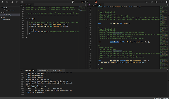

Editor with split screen
Autocomplete
Peek to definition, then Go to definition
