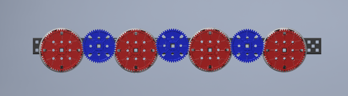

4" wheels

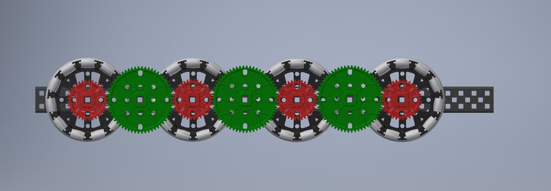

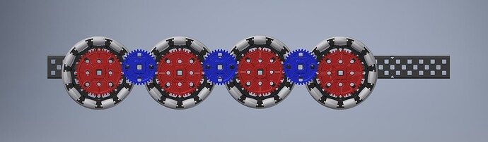

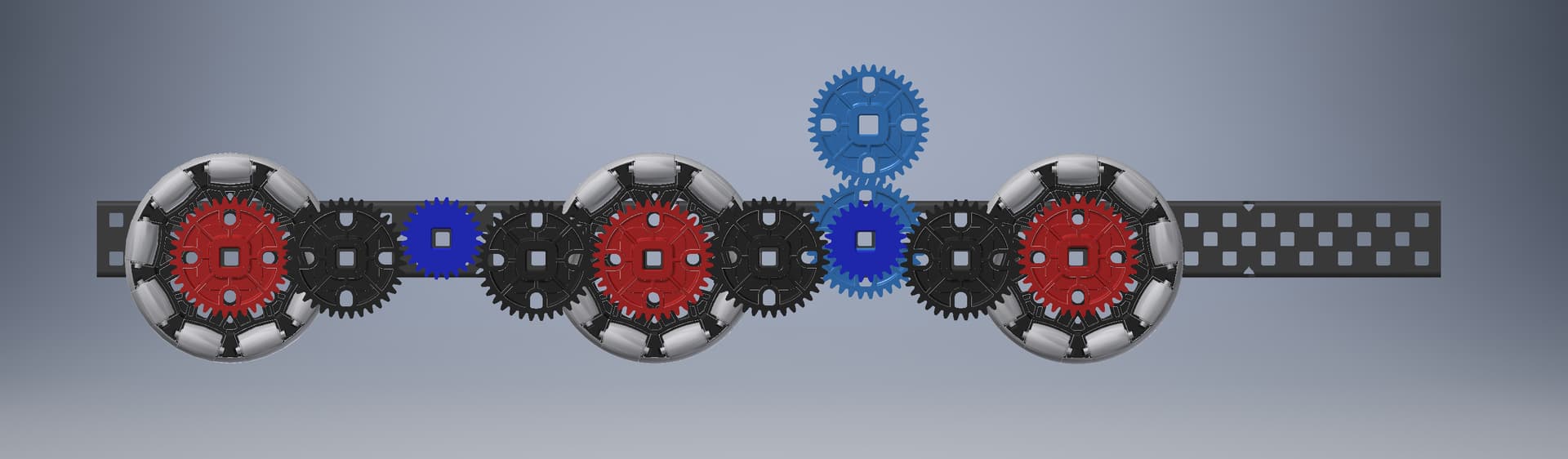

300 rpm (62.8 in/sec)
600 rpm geared down 36:72

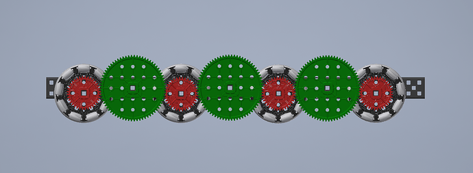

this is a super nice layout, probably the best on 4" wheels.

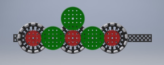

200 rpm geared up 72:48
this is kind of ugly, I don’t know why you would ever do this over the above layout.

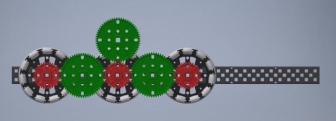

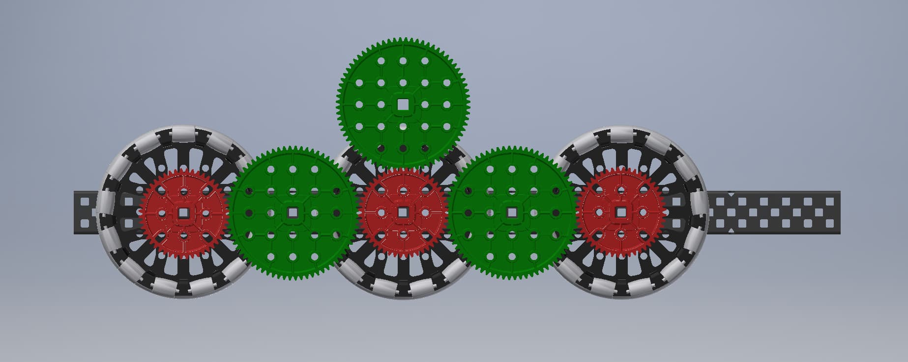

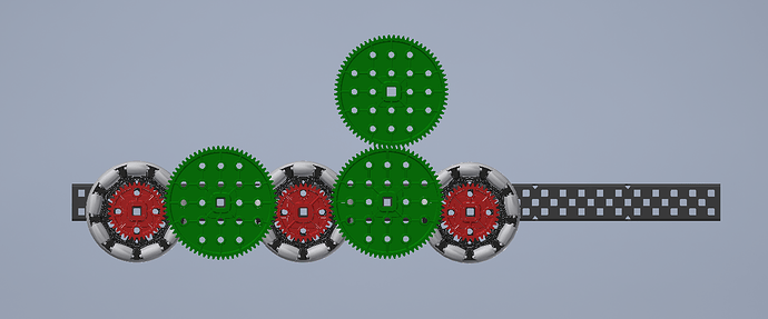

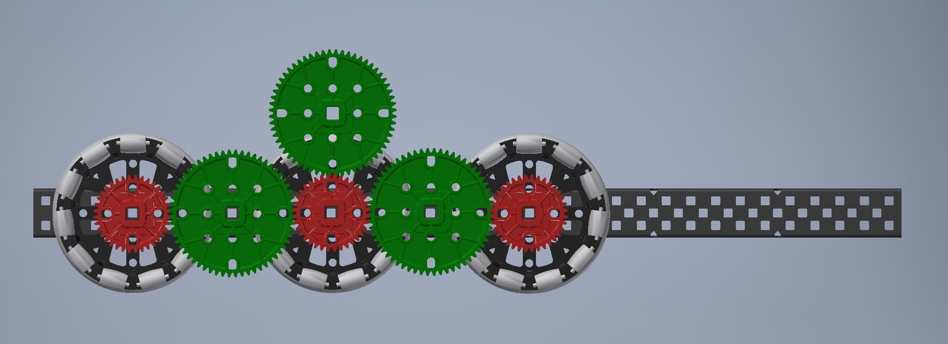

280 rpm (58.6 in/sec)
200 rpm geared up 84:60
I kind of hate how bulky this ratio is. Even though it only uses 6 gears and has no idlers, the raised gear means you have to mount a motor so high up. A better alternative could be to remove middle wheel and then bring down the raised 84t gear, reducing gear count to only 5, sacrificing the ability to do center traction.

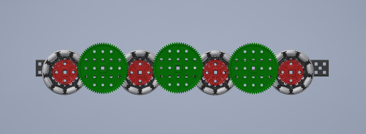

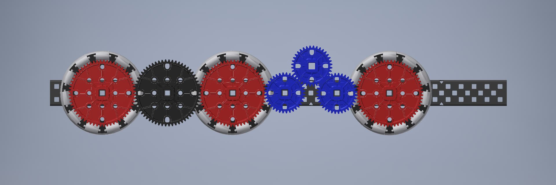

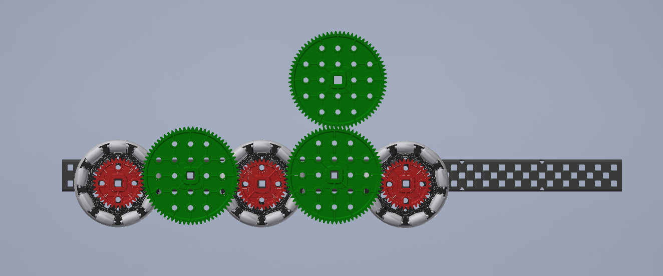

257 rpm (53.8 in/sec)
600 rpm geared down 36:84
very nice layout, a little slow but still a very good option to have a lot of torque and very compact gearing.

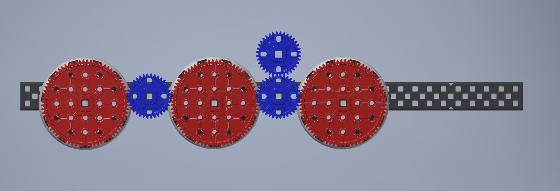

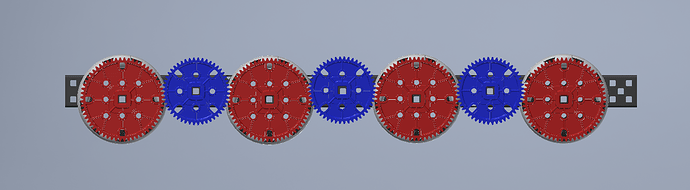

450 rpm (76.6 in/sec)
600 rpm geared down 36:48
very fast, needs to be built very well and driven very skillfully to be viable. Using an 8 wheeled layout like this gives it a reasonable length, though you could remove one wheel and stack the last motor if you’re ok with a very short drive.

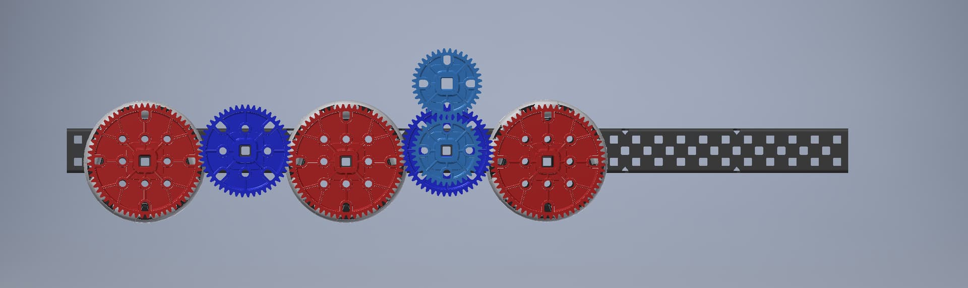

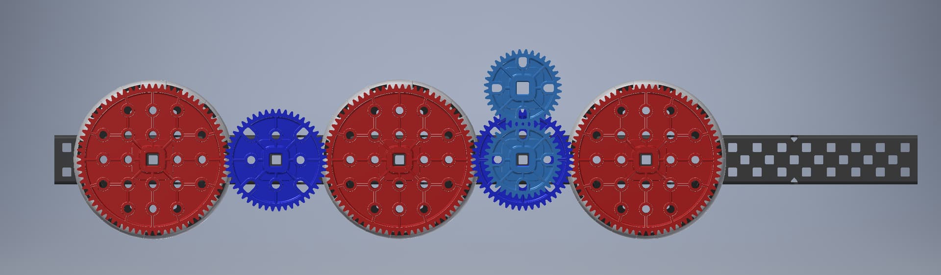

400 rpm (68.1 in/sec)
600 rpm geared down 48:72
In my opinion this is the single best drive layout. It has the minimum possible number of gears, is a great length, and lets you compact the stacked motor very low using a 36:36 compound gearing. It’s pretty fast though so you do need some driver ability to control it well.

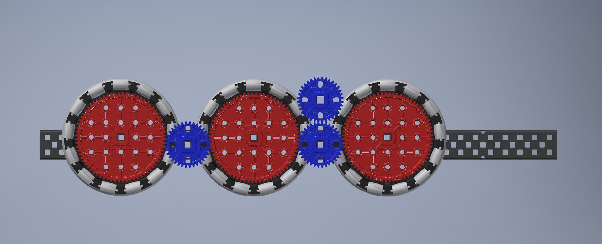

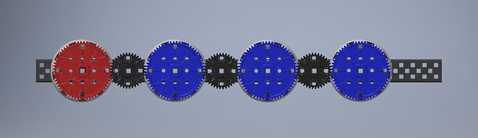

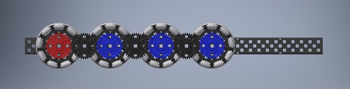

360 rpm (61.3 in/sec)
600 rpm geared down 36:60
Really good, except it’s also really short. Fantastic layout if you’re making a short robot.
Works for longer robots, and has a still reasonable gear count, except that in order to get 3 motors to drive 3 36t gears like this, you need to mount the raised motor at an unusual angle. I do not recommend.
This one is alright, though a little on the longer side, and uses 8 wheels which might not be what you want.
This one is awful, but it’s what a lot of people do to stretch out the gearing.

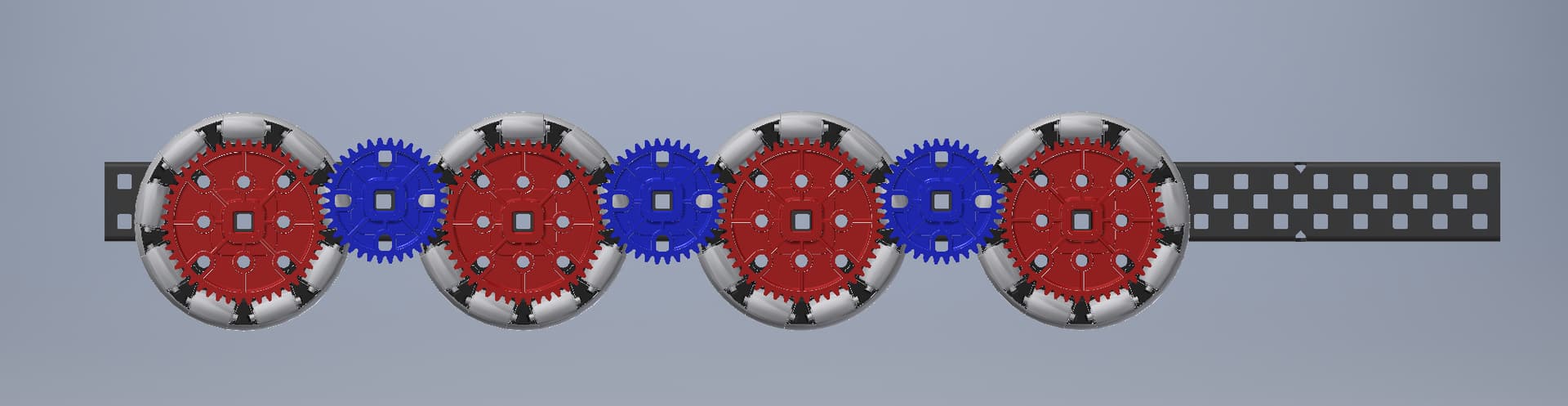

2.75" wheels

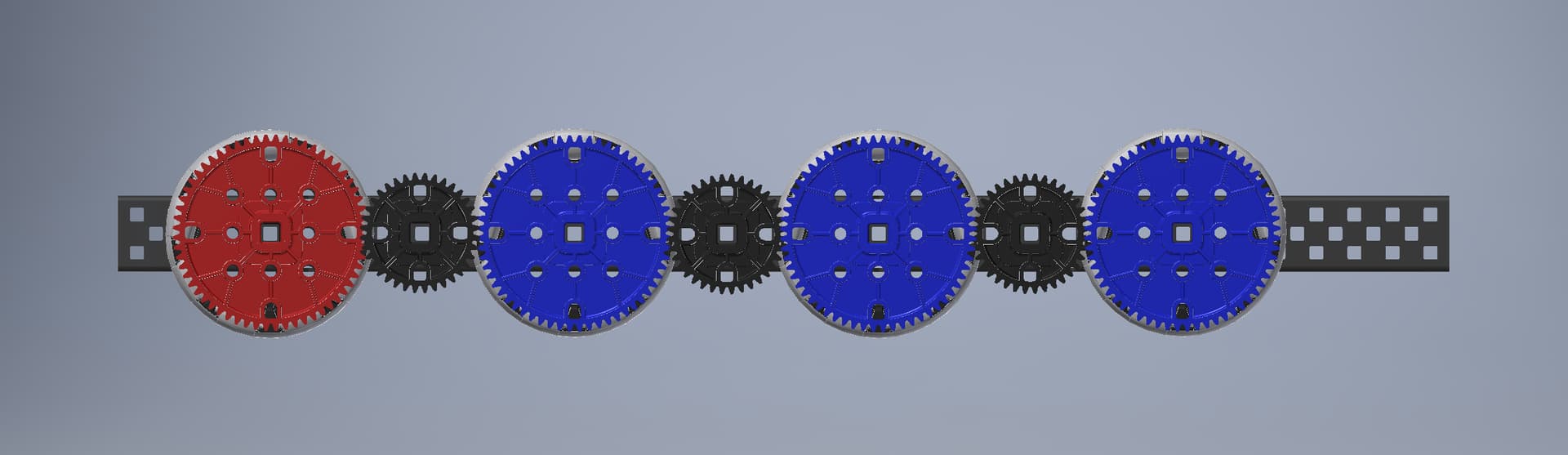

600 rpm (86.4 in/sec)
600 rpm geared 1:1
both of these are decent, though one is long and one short. It is also pretty acceptable to just direct drive 6 wheels without gearing them together, but only with 600 rpm drives, so if you really want to go this fast than it might be preferrable just to not have any gearing at all. There are significant drawbacks to doing this though, and in general I don’t recommend going this fast unless you know exactly what you’re doing, in which case you probably don’t need to be reading this.

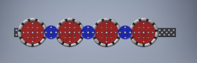

This layout works too, but is a little longer and uses 8 wheels.

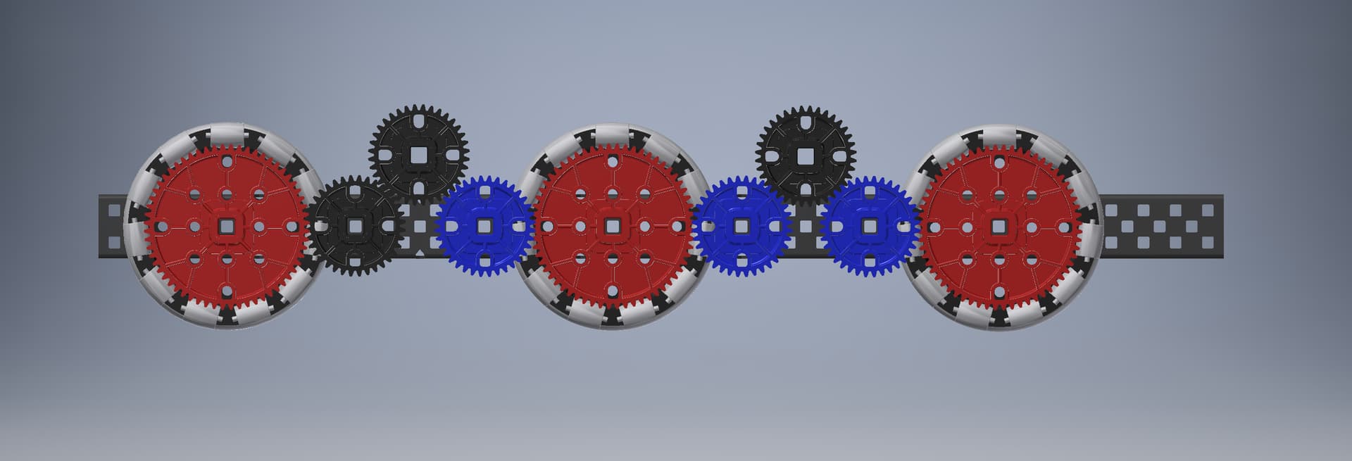

you said that having the stacked offset gears for 360rpm on 3.25 is awful. i was considering doing something like that for 450rpm on 2.75in rpm is there something inherently wrong with it or is it just because there are better option other for more compact?
I just don’t like how many gears there are. 9 gears is kind of a lot when you have similar speed options that use a lot fewer, like 400 rpm 3.25", 300 rpm 4", or 450 rpm 2.75". All three of these layouts have pretty comparable speeds, but only use 6-7 gears.
of course, gearing 360 this way is actually really common, and totally works. I’m just not a fan of having more joints than necessary, and there are plenty of options out there that don’t use so many gears.

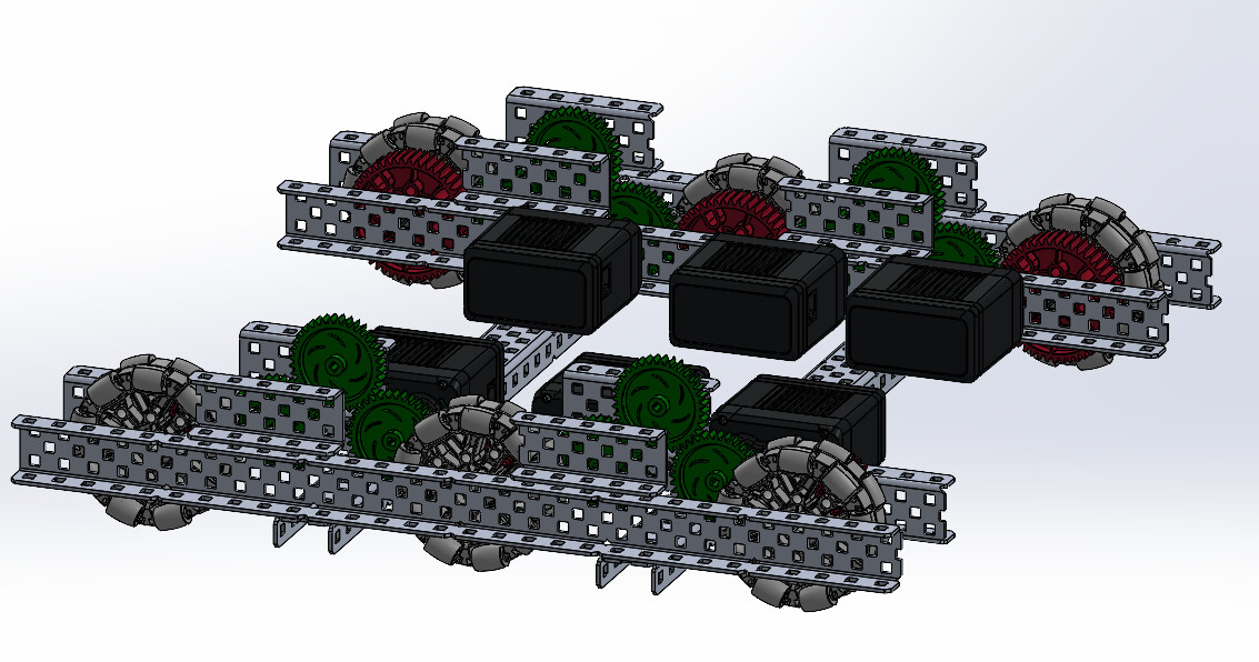

for the 3.25 400 RPM setup, how do you recommend stacking the gears? I put a c-channel on top and the holes do not line up.
1/2” spacer in between the c-channels. See Vex Hex’s video, specifically 1:33. You can see how they stacked motors with a similar drivetrain setup. 606X Spin Up | Drivetrain + Catapult Explanation - YouTube
Try a 3 or 5 wide? Worst case you drill holes.
You can use spacers in-between the 2 c channels. I forget what size spacers our team uses, but everything lines up perfectly.

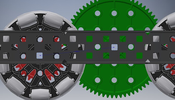

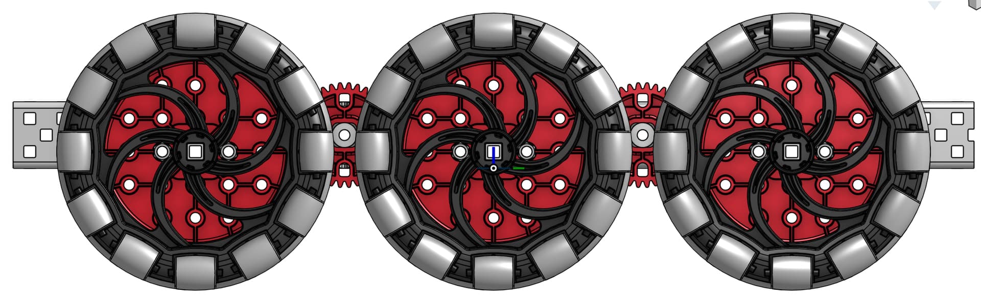

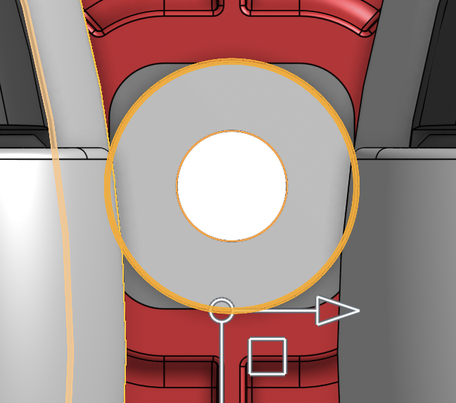

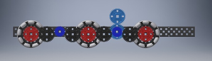

So sorry for reviving this topic yet again but I was making a CAD model of the 300RPM on 4" Omni-wheels also feature in this post and came across an issue when attempting to add spacers to the 36t gears.
As seen above, when a 3/8" OD spacer is put on the same axle as the 36t gear, the spacers clips into the rollers on the adjacent omni-wheels. Has anyone else encountered this problem or have any ideas on how to remedy this?
Sorry again for reviving this thread.
