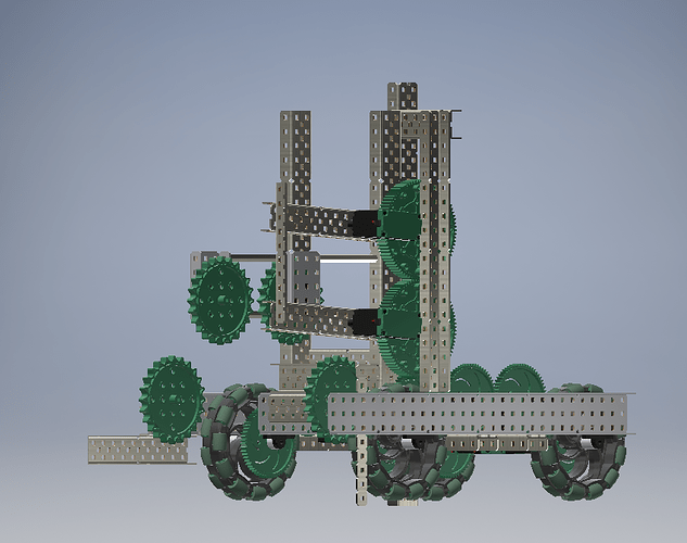

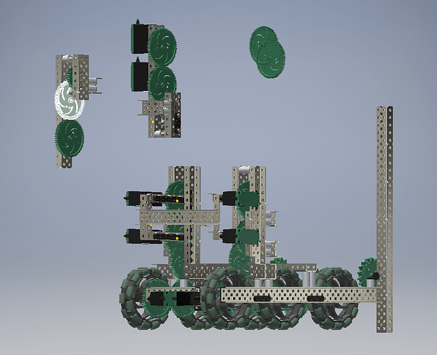

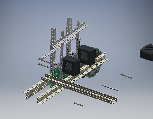

@jrp62 I do my CAD work in inventor, and you can constrain the edges // circumference of the gears together so that they’ll “mesh” virtually - you just have to teach them about gear ratios before you do that and it should be ok. I have a few CAD models, some of them are incomplete, most of them were for prototyping, but I’ll attach them to this message should you wish to review them. (thank you @technik3k for the mention).
This is one robot, I use a vertical channel on the end of the robot to gauge height (so I don’t go over 18") as well as a few c-channels/bars elsewhere to help give me a sense of how “big” everything is.
What you’re seeing here is now a second version of that same robot, there’s a few differences but generally the concept stays the same (I never finished this, so you’ll see a few random gearboxes for the flywheel lying around still).
image image
And of course, there’s the first robot that I cad’d this season (first robot I ever did in CAD) which is on my youtube - you can see me build it. Here’s the link to the first video if you wanted to take a look, and if you want the CAD files just shoot me a message and I’ll figure out a way to upload the entire project in a way where it won’t self-destruct.

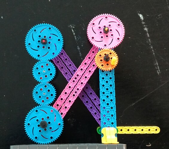

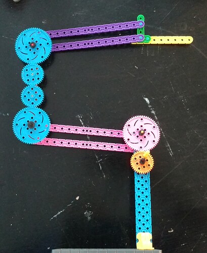

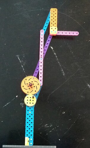

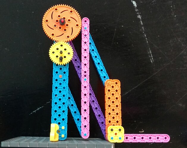

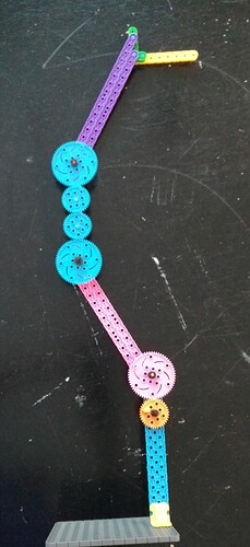

Thank you @ranOOm and @technik3k! Yes please send me the CAD files. Let me explain why I want them…
Below are some pictures of sample lifts that we keep around the lab. Made from Vex IQ parts, we have about ten different types of lift models. You can physically move the lifts up and down to see how they work. We have similar models for gear ratios. These are effective, the kids like looking at them and get kind of hypnotized watching them move. But they take up space, break easily, and are not always handy when you want them.
For differentials, what I would like to try instead is having CAD models that would allow someone to control the movement of the model. As with the lifts, you can try and explain how these things work, but letting kids watch the movement while controlling it is what really makes the concepts sink in.
IMG_20170716_202554347 IMG_20170716_202503976 IMG_20170716_202451340 IMG_20170716_202432154 IMG_20170716_202441009
Lift demos

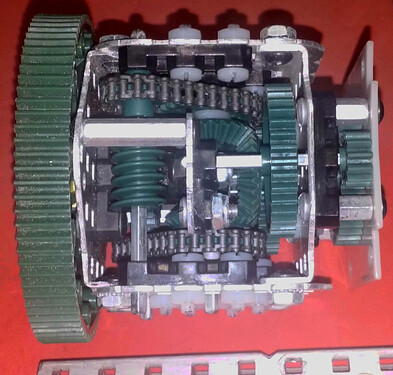

There is a way to solve the motor under-utilization in EVT and get close to 100% efficiency in the high torque mode:
One of our teams tried to build an automatic transmission with the worm gear based (non-backdriveable) differential for ITZ Worlds, but run out of time. It would have been great to have all that extra torque. This is the final and the most compact version we’ve got:
AutomaticWormGearDifferential
In high torque mode, you could get 9 motors worth of pushing power from just 3 actual motors at 1/3 of the max speed. But it isn’t an easy build and takes a lot of time to tune it.

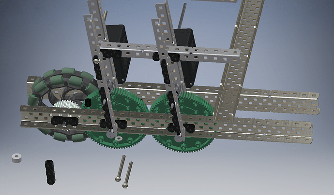

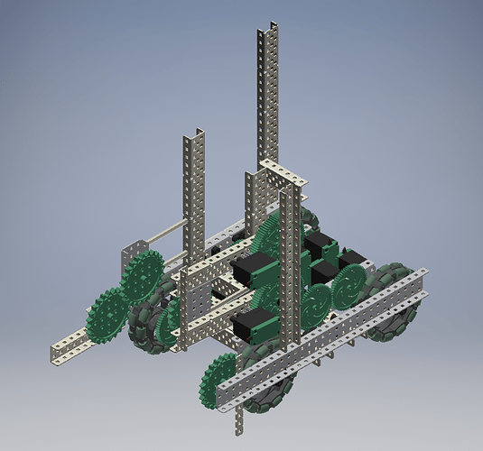

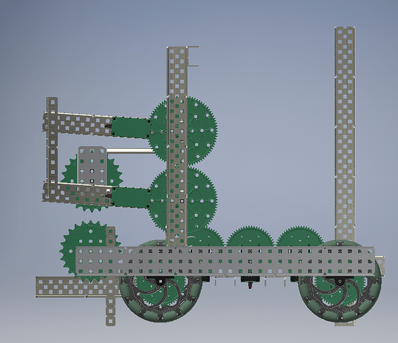

@jrp62 I spent about an hour today just getting started on a CAD (gift to self for finishing my physics exams?), anyways I’ve uploaded the first bit. There’s a bunch of issues with the design if you were to use it in matches, there’s a lot of things that still need to be “considered” and “fixed”, but the basic idea of how the DMD style transmission is there, and I just spend a bunch of time building it. I took a few screenshots and I’ll attach those as well. I’ll keep uploading the build progress for this robot if I end up finishing it at all.
And no, I’m not competing with this. I’m graduated (sad). I’ll do VexU maybe.
#11
Thank you @ranOOm for all your work on this. I actually tried to build the same thing in a RobotMesh mimic, and quickly discovered that the build is more complicated than it looks. It takes so much space too. Reducing the size by using the drilled out gears as @technik3k suggested seems essential for a competition bot. I’d like to get some of my students interested in this, but they are focused on their finals right now. Keeping your video book marked. Thanks again.

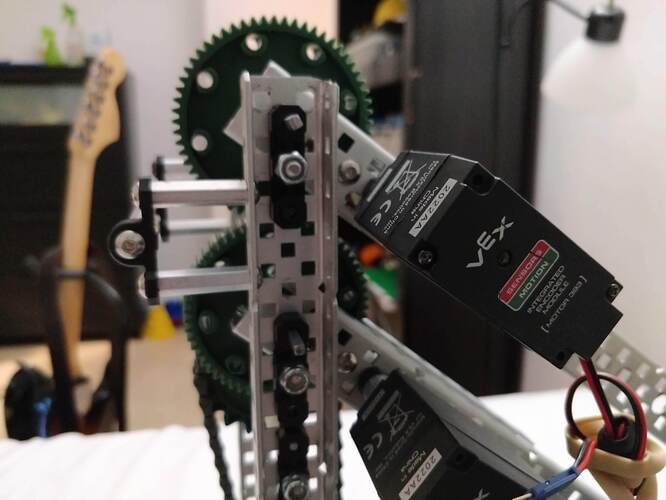

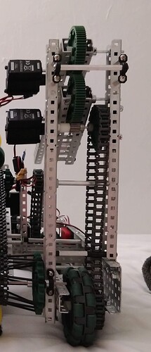

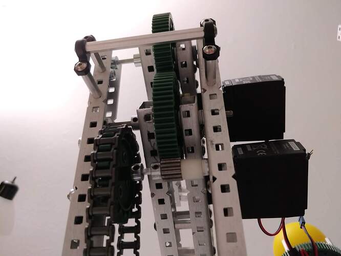

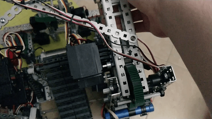

Just to add to this discussion, our original TP bot used a standard 4-bar differential between the chassis and lift. It allowed us to have a 6 motor drive, 4 motor lift, 2 motor catapult, and 1 motor intake, while only using 9 motors total.
The original design had an active flipper and a pneumatic claw, but we ultimately scrapped those because we literally never used it. Instead we rebuilt our lift into a descorer, which is what you see in the video.
It worked extremely well once we fine tuned it a bit- this was our first ever test, so don’t be too hard on it lol.
You can see the lift sag a bit when the chassis is moving. This is because I used a fairly weak PID on the lift controller. It was much stiffer when I tightened the controller up. Additional bracing helped as well, since we had more or less none in the video.
The big thing to remember is that both speed and torque are severely reduced when you run both subsystems at once. Not only is the torque being distributed among two systems rather than one, but half of the motors are actually off as well. Less intensive actions such as holding a lift while moving the chassis is probably going to be fine (depending on the load of course), but I would highly recommend not linking any subsystems which will frequently run simultaneously. For instance, a lift for ITZ would have been a bad idea to tie to a chassis. A mogo lift, however, would have been very useful since it was used so rarely and generally could be used while the robot was stationary without losing too much drive efficiency.
Here’s a few photos of our implementation, at different stages in the building process:
Screenshot_20190522-065953_Photos MVIMG_20180929_201338__01 MVIMG_20180929_201254 MVIMG_20180929_201307
Special partially threaded screw joints and HS gear bearings using modified 393 output gears
