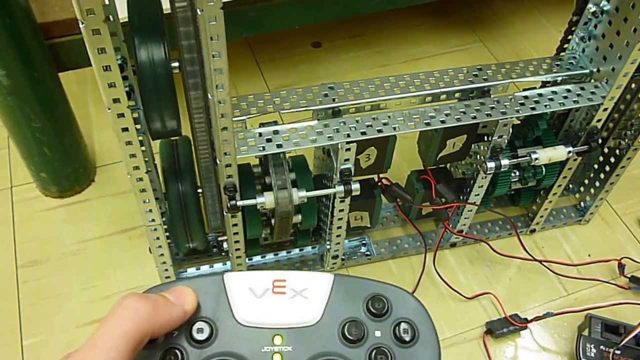

Below are the pictures of the differential prototype that uses drilled out 393 output motor gears as the coaxial bearings:
This allows the main axles going out from the motors to avoid the load of supporting the 60T gears to which the motors are attached themselves. Also, for stability you need to connect those gears on the left and right drivetrain sides:
Another important thing to consider when building differential is if you need to power both outputs at the same time. They can run independently and simultaneously but only at the reduced power. You get the best efficiency only if power is going to one output at a time.
(short demo illustrating the above design: https://youtu.be/dKvAmZ_Dym0)
Let say you have 4 motors in differential setup (2 per drive side). When you run only one function then you get full power of those 4 motors for each function independently (100%) efficiency.
If you try to run both functions at the same time, then the sum of velocities is capped at 100% and the sum of forces is capped at 100% too. In the worst case (when half of the motors hold 0 rpm) each function gets only 50% of max force (torque) at 50% of max speed, thus resulting in 25% of max power for each of the functions or 50% overall efficiency.
If your game strategy calls for both functions to be used simultaneously most of the time, then differential is a bad option, but if those functions are mostly exclusive, then differential makes a lot of sense.
Peak power is another consideration. It may be ok to sacrifice overall efficiency of the system, to get peak pushing power of the chassis when the lift is not active. For example, if you have 6 motor drivetrain with 4 motors shared with the lift, then you get effective power of 1 motor lift and 1+2=3 motor drivetrain if you use them simultaneously. But if you use them only one at a time, then you get either 4 motor lifting power or 6 motor drivetrain.
This all assumes that you don’t lose too much to friction in the more complex geartrain.

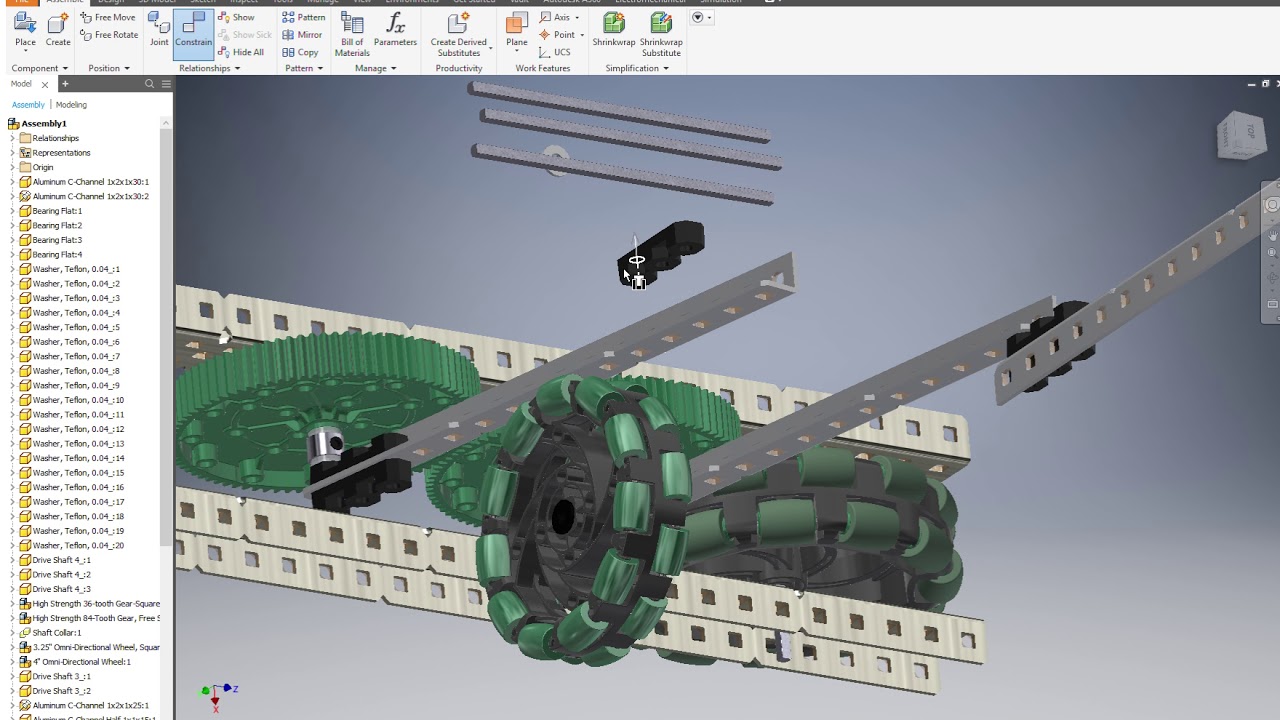

@jrp62 I do my CAD work in inventor, and you can constrain the edges // circumference of the gears together so that they’ll “mesh” virtually - you just have to teach them about gear ratios before you do that and it should be ok. I have a few CAD models, some of them are incomplete, most of them were for prototyping, but I’ll attach them to this message should you wish to review them. (thank you @technik3k for the mention).

Thank you @ranOOm and @technik3k! Yes please send me the CAD files. Let me explain why I want them…

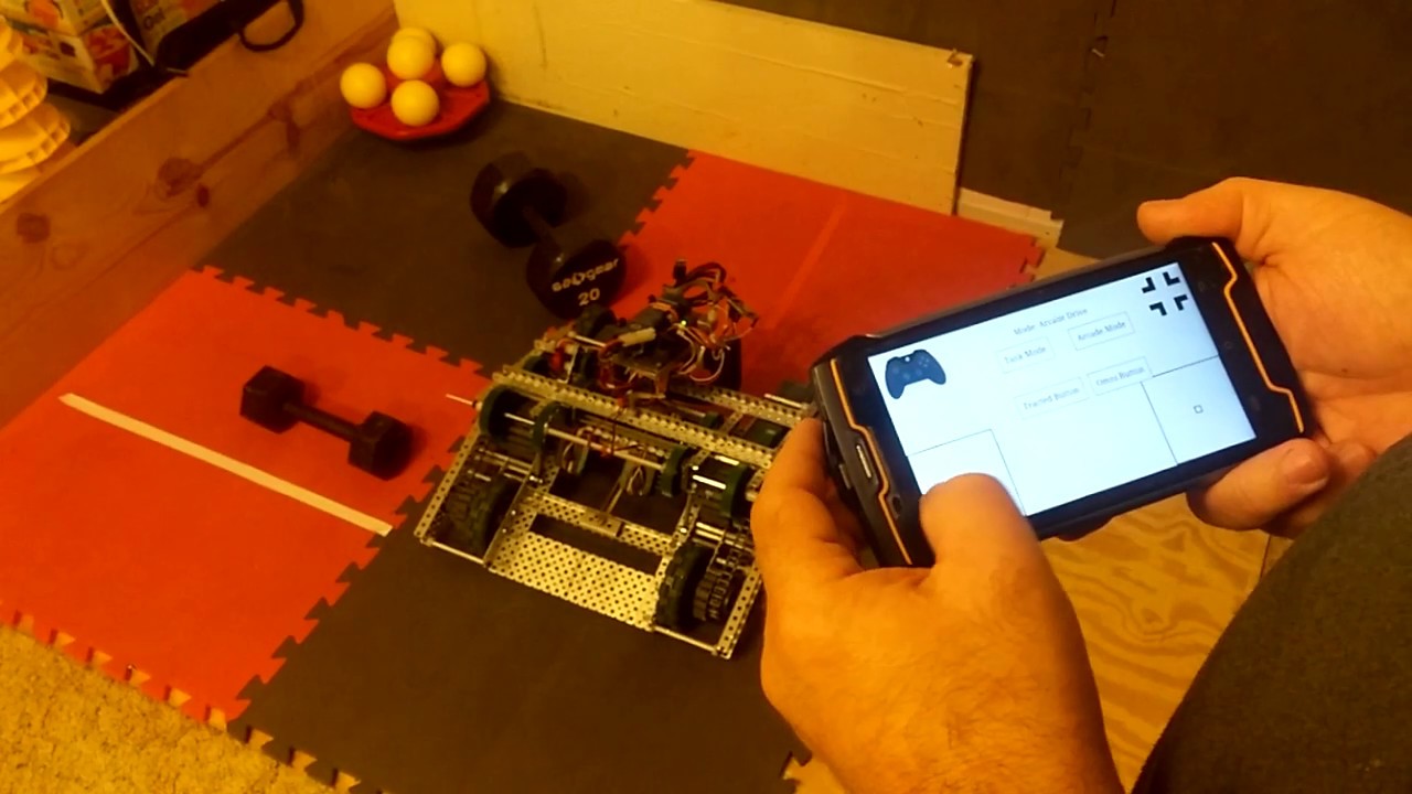

Below are some pictures of sample lifts that we keep around the lab. Made from Vex IQ parts, we have about ten different types of lift models. You can physically move the lifts up and down to see how they work. We have similar models for gear ratios. These are effective, the kids like looking at them and get kind of hypnotized watching them move. But they take up space, break easily, and are not always handy when you want them.
For differentials, what I would like to try instead is having CAD models that would allow someone to control the movement of the model. As with the lifts, you can try and explain how these things work, but letting kids watch the movement while controlling it is what really makes the concepts sink in.
Here’s a model drivetrain that my older son made that uses differentials for a CVT. The kids loved driving it and watching the gears move, but I’m not sure how many of the IQ kids understood it. They might be ready for it now. Apalrd's CVT/EVT

Right now most of our students are busy preparing for tests, but I will definitely talk to them later to make a good CAD. The best I could do now is to link a few more videos.

I don’t know anything about CAD, other than what it’s supposed to be capable of in a CAD utopia. So it sounds like using a full blown CAD app would have too many obstacles just for demonstrating simple models. RobotMesh has this minimal CAD app integrated into their development studio, that they call ‘mimics’. I tried it, it was easy to learn, even for an old dog. I’m going to try to create a differential mimic like the antichamber drivetrain, we’ll see how it goes. Part of the motivation to do this in CAD is to get the kids familiar with it earlier. In VEX you don’t really need to use CAD to have a good robot. However, our FIRST team is heavy on CAD, and the kids that join have a steep learning curve, making them less engaged during the design phase.
You are correct, the main issue with that CVT drivetrain my son built was that it was inefficient, especially under the load of a big robot. Some of our teams built it, but no one ever stayed with it for a competition robot. Experimenting with those other drivetrains you posted will be a good summer project

@jrp62 I spent about an hour today just getting started on a CAD (gift to self for finishing my physics exams?), anyways I’ve uploaded the first bit. There’s a bunch of issues with the design if you were to use it in matches, there’s a lot of things that still need to be “considered” and “fixed”, but the basic idea of how the DMD style transmission is there, and I just spend a bunch of time building it. I took a few screenshots and I’ll attach those as well. I’ll keep uploading the build progress for this robot if I end up finishing it at all.

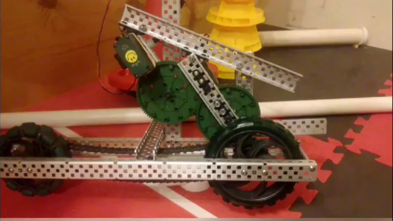

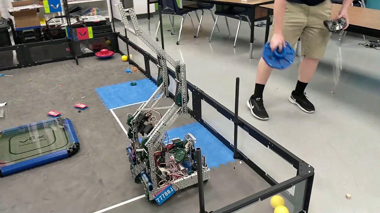

Just to add to this discussion, our original TP bot used a standard 4-bar differential between the chassis and lift. It allowed us to have a 6 motor drive, 4 motor lift, 2 motor catapult, and 1 motor intake, while only using 9 motors total.
The original design had an active flipper and a pneumatic claw, but we ultimately scrapped those because we literally never used it. Instead we rebuilt our lift into a descorer, which is what you see in the video.
It worked extremely well once we fine tuned it a bit- this was our first ever test, so don’t be too hard on it lol.
You can see the lift sag a bit when the chassis is moving. This is because I used a fairly weak PID on the lift controller. It was much stiffer when I tightened the controller up. Additional bracing helped as well, since we had more or less none in the video.
The big thing to remember is that both speed and torque are severely reduced when you run both subsystems at once. Not only is the torque being distributed among two systems rather than one, but half of the motors are actually off as well. Less intensive actions such as holding a lift while moving the chassis is probably going to be fine (depending on the load of course), but I would highly recommend not linking any subsystems which will frequently run simultaneously. For instance, a lift for ITZ would have been a bad idea to tie to a chassis. A mogo lift, however, would have been very useful since it was used so rarely and generally could be used while the robot was stationary without losing too much drive efficiency.

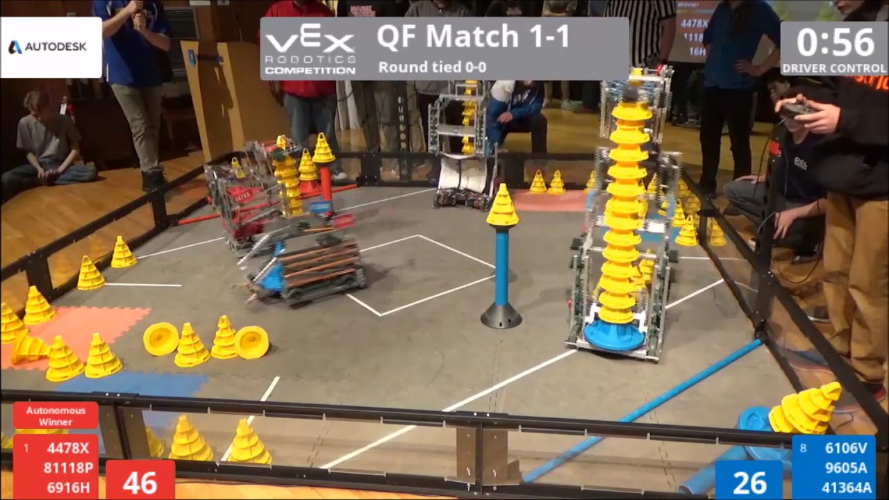

I still need to search through the old posts on some Discord channels for more pictures and videos of ITZ season robots…
For now here is one of a first public sightings of the lift to MoGo differential.
It is 9605A robot at North Andover HS at 8h34m57s:
And also at SNEC:

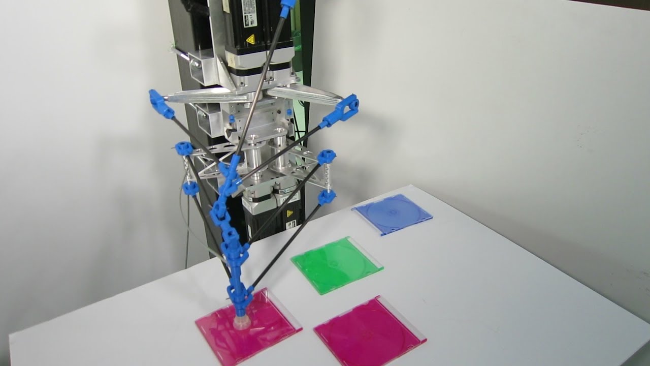

This is not much related to this season’s game, but here is a couple of interesting examples of using kinematically redundant linkages to perform secondary functions (also known here as differentials):
Notice the 4 degrees of freedom (DOF): horizontal, vertical, rotation, and claw that share 4 motors that are powering the belts.
The similarity between them and VRC is that, instead of using separate and potentially differently sized motors for each function, you use an array of identical motors where they power the major speed and torque demanding function together, and then the secondary functions are actuated by differential control of those motors.
This is also related to the design of Delta 3D printers and pick and place robots:
