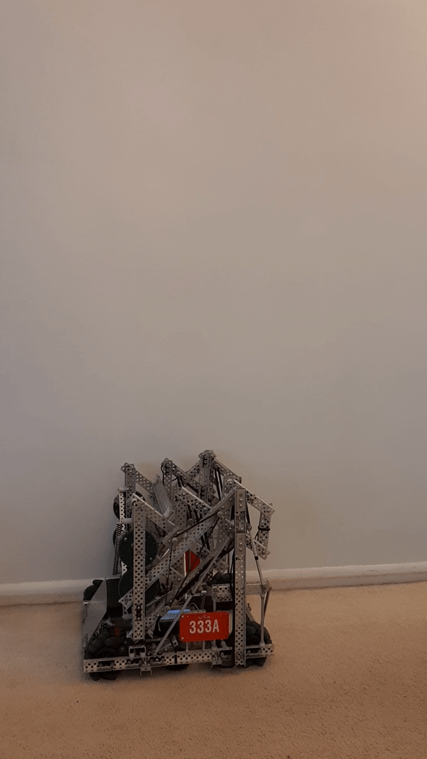

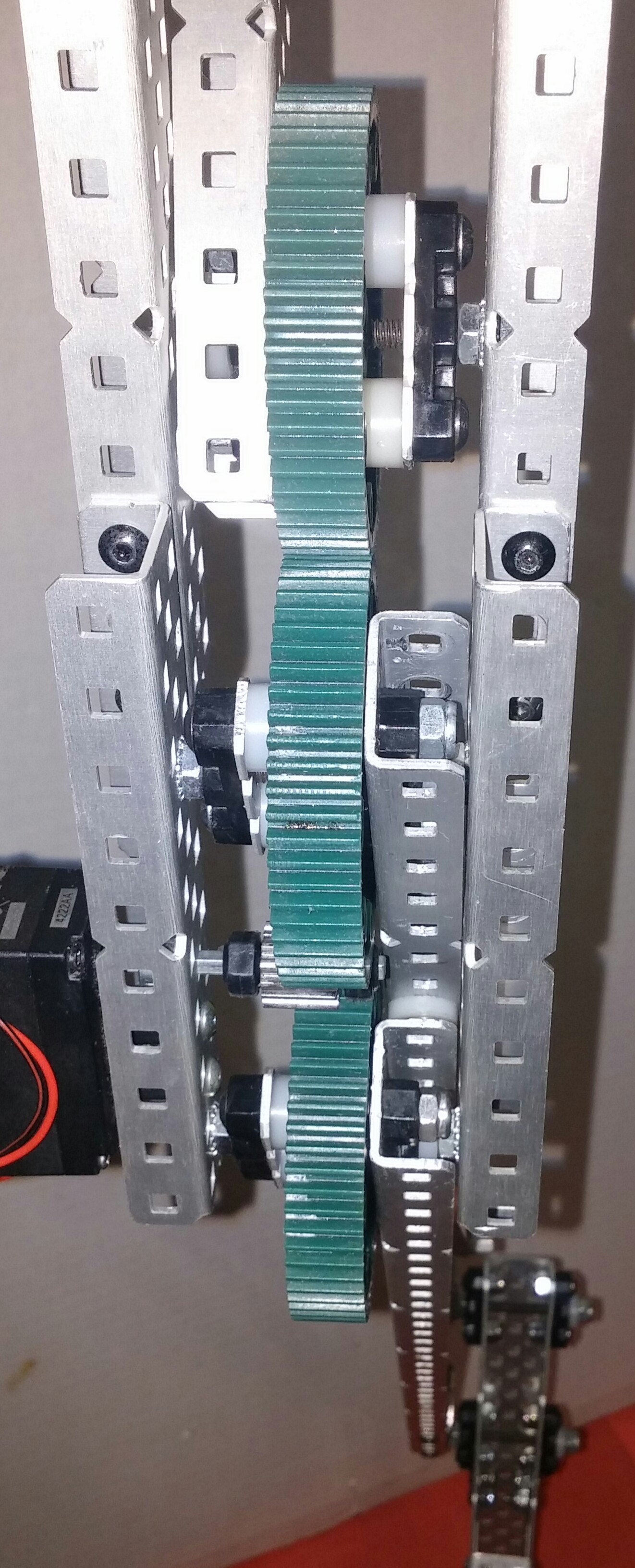

Some highlights of the DR4B/8B that we built at the beginning of the Tower Takeover season:
These are bearing extensions on the rotating bars of the lift. They extend as far as possible while still allowing the screws to go through both sides of the midsection. This minimizes wobble as much as possible:
These are some of the bracing techniques we used, namely X Bracing and K Bracing. They both use triangles to reinforce the lift, since triangles are the only rigid 2D shape. This prevents a lot of torsion that would otherwise become a problem:
This is the rubber band triangle on the bottom linkage of the lift. Using a triangle formation allows the lift to raise with uniform acceleration, which allows for more consistency in a competition. We but them around loose spacers to allow the rubber bands to rotate without the risk of snapping:

The most important takeaway from our research was that you should use screw joints whenever possible. This change had the greatest impact on the stability of our lift, and forever changed the way we build anything.
Bracing is also very important, and can’t be overlooked. There are many effective ways of bracing, and all of which have their respective benefits.
Lastly, we learned to not fear the unknown. Had we not tried new things, our lift would still be a twisted wreck that lifted at an angle. Learning more about DR4Bs has not only improved our lifts, but all other aspects of our building.

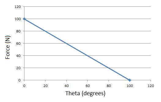

However, some of you may have come across some flaws with this sort of tensioning system. The rubber bands have a greater upward force when the lift is at the bottom, while the upward force starts to diminish while the lift rises. What this means is that as you lift upwards, the assistive force of the rubber bands start to disappear, as the motors begin to have to do more work. The lift then reaches a point where the rubber bands are completely slack and has no assistive force on the lift.
I created a graph to better illustrate the situation:
Obviously, the numerical values are not accurate as the rubber bands won’t be producing a 100N of force on the lift, but the concept is the same. The Graph also may not even be linear, but the point is that the force diminishes as the lift angle increases.
In addition to the fact that the rubber bands do not work effectively when the lift is raised, high upwards force near the bottom of the lift is also not ideal. With no game pieces in your robot, the lift may start to rise on its own because of the strong upwards force of the rubber bands. One may combat this problem by taking off rubber bands, further reducing the effectiveness of the rubber bands. Others may put a small constant motor value in the code ( while (lift is down) motor value = -10; ) but this is still not ideal.
An ideal graph would look like so:
Constant upwards force regardless of the position of the lift.

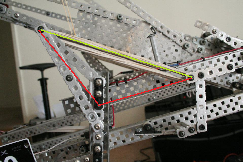

My discovery of the uniformly tensioned rubber band system (UTRB for the sake of the phrase’s length) made its way during the 2012 gateway season. While creating a pneumatic lift, I discovered that a UTRB was absolutely necessary due to the fact that pneumatic pistons are quite weak, but also have a constant force along its stroke (save for minimal amount of loss force due to the fact that air gets released every time you activate one). After the robots completion, the robot was able to lift 6 game pieces (3 pounds) to 30” and still be able to bring the lift down with 0 pieces (no weight) all while having a pneumatic lift. To put this in perspective, the pistons could not lift the manipulator up at all without any type of rubber band system. This should demonstrate the effectiveness of the UTRB.
How it works:
Let’s look at the UTRB when one’s lift is all the way at the ground.
If you look carefully, you can see that the rubber bands almost cross the pivot point of the lift.
This means that the force acting on the lift by the rubber bands is very small.
R (crossproduct) F = Torque
Or
R sin(theta) F = Torque.
When theta approaches 180, sin(theta) approaches 0.
Now when the lift is halfway up:
sin(theta) will be greater
When the lift is at the top:
Sin(theta) is the greatest here with a value of 1
Now coupled with the fact that the force of a rubber band decreases as the length decreases and the value of sin(theta) increases as the lift increases, what we get is a(n almost) uniform torque (upwards force acting on the lift).

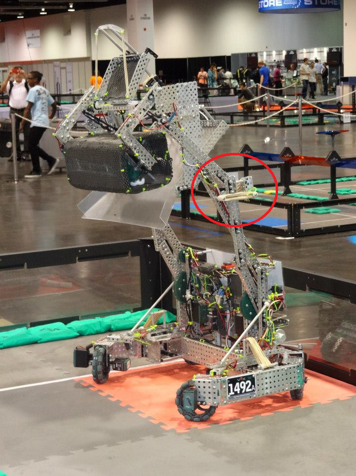

Interestingly enough, during this comp, I noticed that another team had come up with this type of tensioning system. One of 1437’s viewpoint robots had this tensioning system in the back of their robot. (If you look closely enough on the red side, you can see that the back of their robot has a bar jutting out of the back of their lift, which is the same UTRB, but just located in the back).

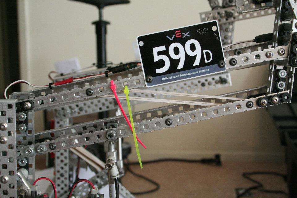

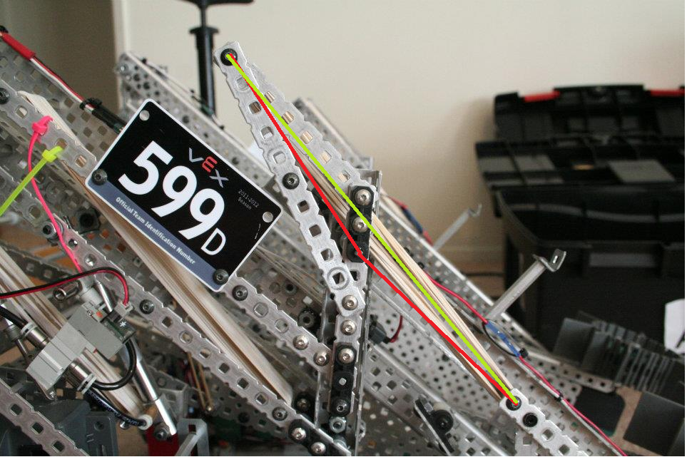

Now in 2013, John Ma and Kevin Li from WASABI used my tensioning system but in a much simpler way
And here is a video demonstrating their lift:
https://youtu.be/yngtgmTHRRU
The picture, being the more updated version, demonstrates how they only used a couple pieces of metal rather than my original heavy structure (made with a bunch of straight bars and standoffs). Their structure reduces the weight of the structure and I believe this is the simplest it could become. (Use this structure is what im saying basically).
